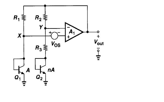

HI :
I am trying to design a bandgap , and the topology is like below ,
The supply voltage is between 2.4 to 5.8 (v) , and i use .6um process
The temperature is vary from -40 to 130 degree
The opamp that i used has 75 (dB) gain and 60 phase margin

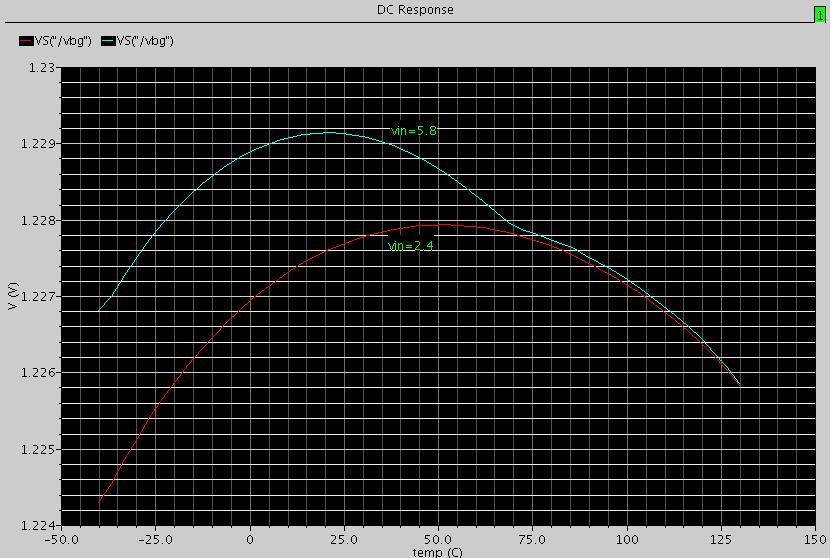

My question is that, when the supply voltage is larger the curve like below
seems not correct, but i have sure that the output stage has enough drive
current, and opamp gain and phase margin is enough .
Can anyone give me some suggestion that any thing i didn't concern?
Thx!

You should simulate your ckt in different corners, rather than in different supply voltage alone.

Your circuit seems working, and it's natural that BGR behavior varies with VDD from 2.8V to 5.5V. You can check if DC operating points all shift.
One common solution to this problem is to add LDO on top of BGR unless you would like to try very high PSRR opamp (some literatures can also br found for these school of circuits).

As some one also said, the band gap reference only works if we have an IDEAL op map during the whole range. I think your op amp stops working after a certain point.

It doesn't seem too bad, but I agree that it could be improved. 75 dB should be enough gain to keep this profile correct from 2v-6v.
Maybe you get an offset current you weren't expecting.
I'd have to see your op amp to be sure, but I am guessing that somewhere (in a cascode, or just a source follower) you use an NMOS whose body is tied to source, and whose source is not ground.
Therefore, any impact ionization from the increased input voltage will cause your drain current to increase and it will affect the operating point of your amp.
Try looking for the body current in simulation, or just tie all the bodies to ground and see if your bg profile is fixed.

To be sure that the AOP is the affected Bloc, you can simulate with an ideal AOP.

Do you have a start-up circuit?
Re: bandgap reference
you'd better check the dc point of the apamp making sure the correct function of locking the input voltage the same.
according to the curves, the temperature at Tc=0 changed because of the current flowing through the transistors. This is just my guess.
Would you like to show the schematic of opamp? I am curious about the buffer stage. Thank you

Please post your OPAMP circuit.
What is the current for each branch across the temp range at different VDD?
