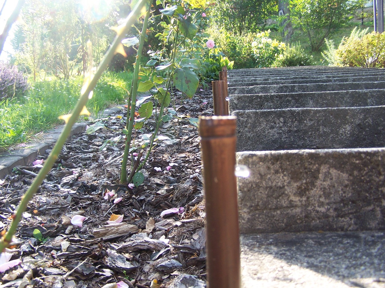

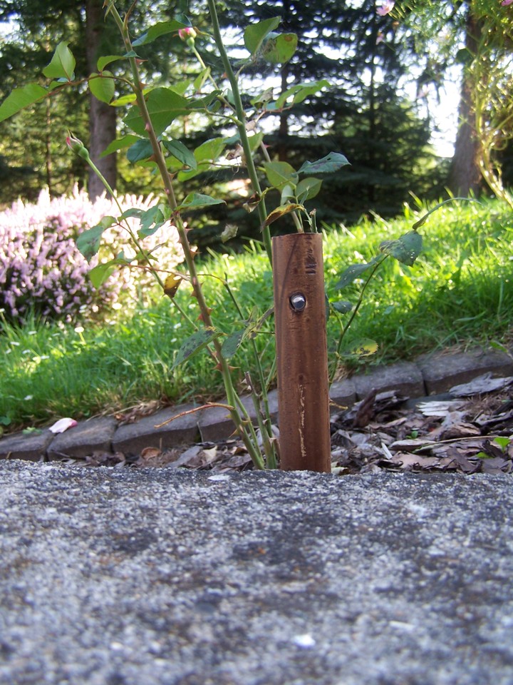

Then was the housing for LEDs. At first, it was planned to be an aluminum pipe and transformed solar lamps. The final choice was bamboo, because it's a cheap and easily available material with a hole inside, where the wires can be placed. Because the stairs were illuminated from outside, bamboo had to be protected against rot. It was made by brown wood lacquer.

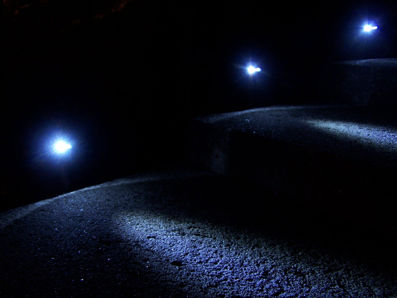

The whole device is controlled by Atmega8. Although it has only 3PWM, mutliplexing had to be done. Each PWM canal powers 8 LEDs (23 stairs/LEDs). When lighting up, 3 next stairs which should be still dark, light a little. Most of LEDs are placed in bamboo, but few of them are placed on a concrete wall on the bend. The lightness is 20 000mcd and 60° angle. The sensors are simple motion detectors, they're excellent for this purpose and kept in a waterproof housings.

Program was written in C. It lights up and extinguishes one stair after another. In the future, the algorithm can be improved so it lights up one step 50%, another one starts to light. The stairs illuminate from the side where somebody comes. They extinguish from both ends to the center. This feature eliminates such problems as how the microcontroller can detect the situation when somebody turns in the middle of the stairs.
