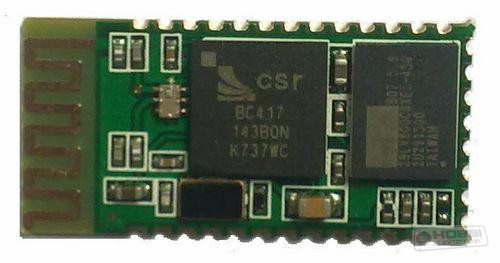

Supose we have 2 Bluetooth module like RF-BT0417C
datasheet here:
can i pair this, in that way to send and receive audio analog signal, between both module in both sense (like semi-duplex not duplex mode - send, then receive) ?
any help is welcome, thank you !
Yes you can do it with one chipset like this and other a bluetooth device. you can send and receive data, but needs a lot of programming for that at application level, as the chip supports A2dp, and AVRCP both.....
