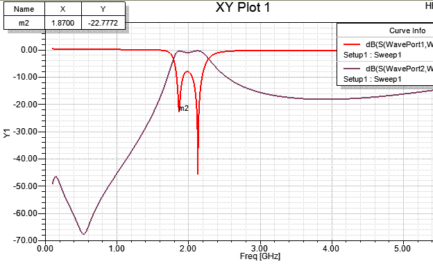

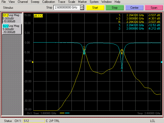

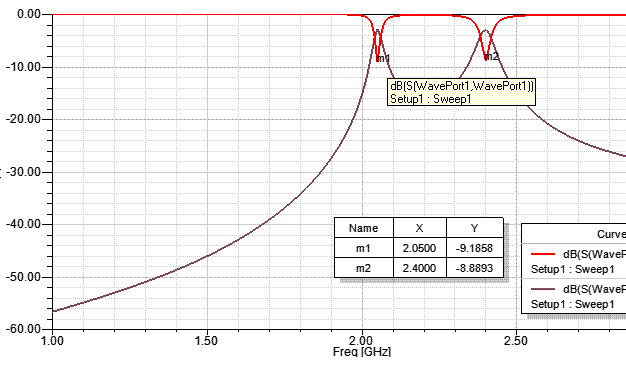

here is my filter working in 2GHz.
But i have a problem on it. I simulated it in HFSS with two same models, i found their resultes are different. in one, the two resonators can coupled as shown
the other can not coupled.
I realised it, the results more close with the uncoupled one.
i am sure the radiation boundary (300/(1.5*4)) and solution frequency 2.0GHz are the same in this two models.
what is the problem? How can i obtain a 2GHz bandwidth as a bandpass filter with this structure?
Thanks everyone!

It's easy. You only need to increase your input and output couplings and it will be all right.
Good luck!

It looks like you have slightly over coupled resonators in the first case and two uncoupled resonators in the second. What you need to do is adjust the coupling and then check the input and output matching.
Best regards,
RF-OM

Thanks RF-OM and Phytech.
But how can i increase the coupling? i had try to increase and decease the distance of the center slots. But in simulation, just this dimension it can couple.
One more question, is the real loss bigger, so this filter can not couple?

The coupling you referred to is coupling between resonators, k12. In order to realized a filter, you need to couple your filter to outside world, namely, kin and kout, the input coupling and output coupling. What I was saying in my last post is that you need to increase kin and kout. Both your simulated curves showed the kin and kout are smaller than needed. On the other hand, you can reduce k12, then you will narrow your bandwidth.
The the loss is too big, the filter insertion loss will become big. But it has nothing to do with the coupling.
Hope this helps.
I mean to adjust both couplings internal and external. Internal or distance between rods will affect the bandwidth and overall filter shape. External will affect insertion loss and matching, these parameters are closely tight and always follow one another. If you have poor matching you have big ripple and insertion loss.
