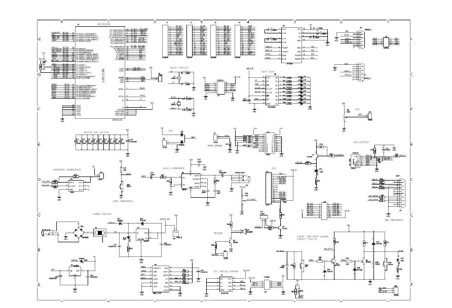

hi sir,
here i am sending you the images of my new arm kit and its sechematic.i am not able to burn the program in this.i always get the error autobaud fail.usb cable is correct.i am using flashmagic tool and compiler is keil 5.
https://obrazki.elektroda.pl/2838862800_1442908352.png
https://obrazki.elektroda.pl/2047912000_1442908700.jpg
these are the links of my schematic and image of arm kit
Sir,
I buy a new arm lpc2148 kit.but it is not programmed by lpc2000 ver2.2.2 flash utility aor not by flash magic.when i am burning it with lpc2000 flash utility then i got error "can not communicate with test board" and if using flash tool then got the error of autoabud.i checked the serial cable it is properly working.here i am sending you the schematic of my arm kit and coding of led.
