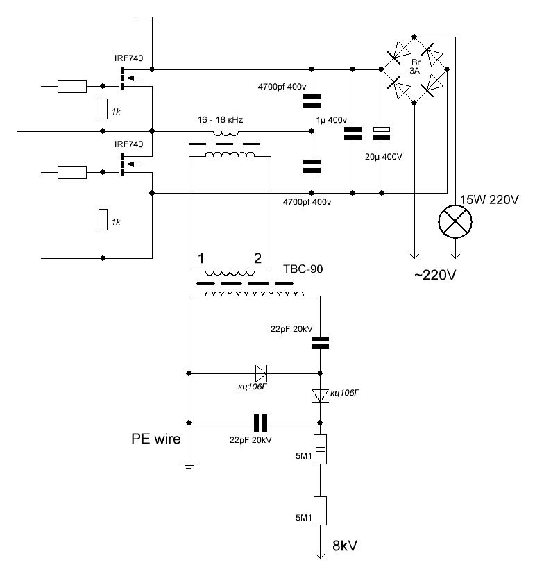

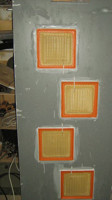

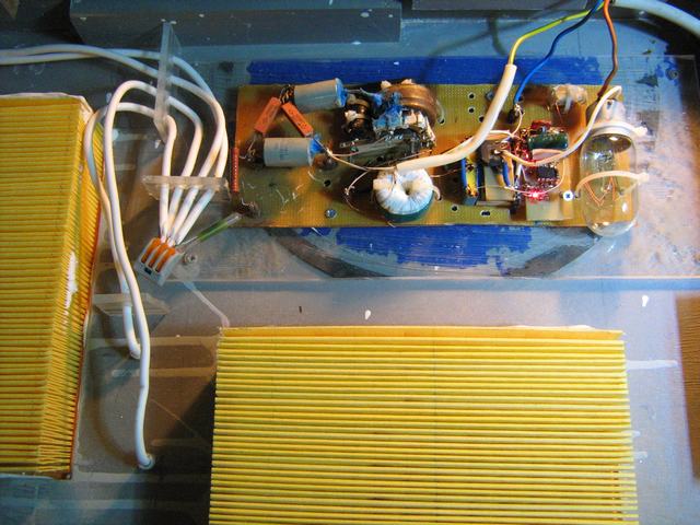

From four car air filters and HV generator (on the base of the converter with ir2153) since such filters itself certainly is not very efficient.
The ventilator with its controller is taken from cheap chinese air defogger, useless in its main purpose.

I have no suiting instrument for estimation, but s impression that filter, when HV is on, catches floral pollen.
