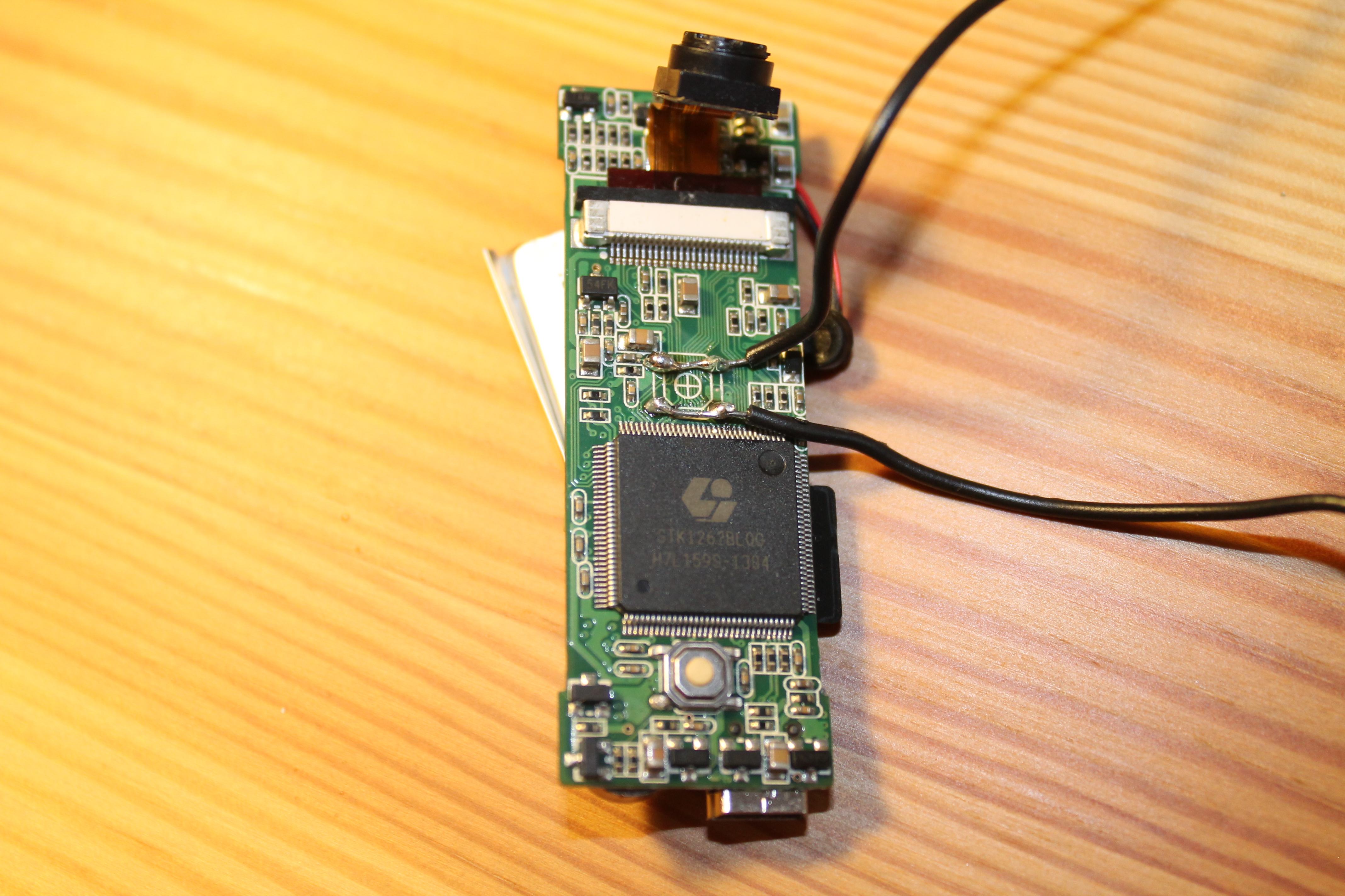

So i opened it up! it's exactly like you said, there are 2 button that look exactly like that!
I see that there are 4 metal lines coming from each corner of the buttons, i guess i have to attach my bluetooth reciever to all of them?
And when i press my bluetooth that the reciever closes the circuit and the machine think that i press the real button.
Is that how it should work in theory?

Yes, this buttons are tasters.
Check with ohmmeter button pins, you need to use only two pins from each button.
Use thin wires from UTP cables.

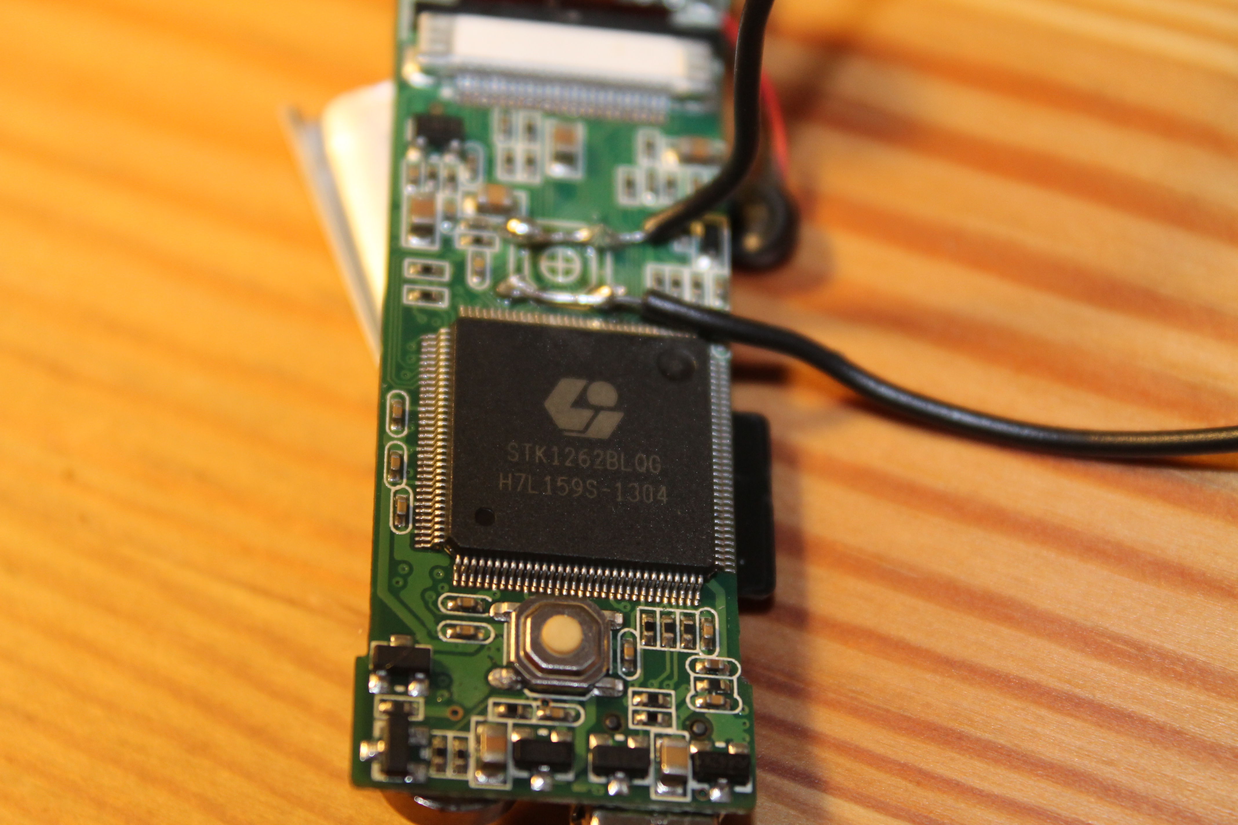

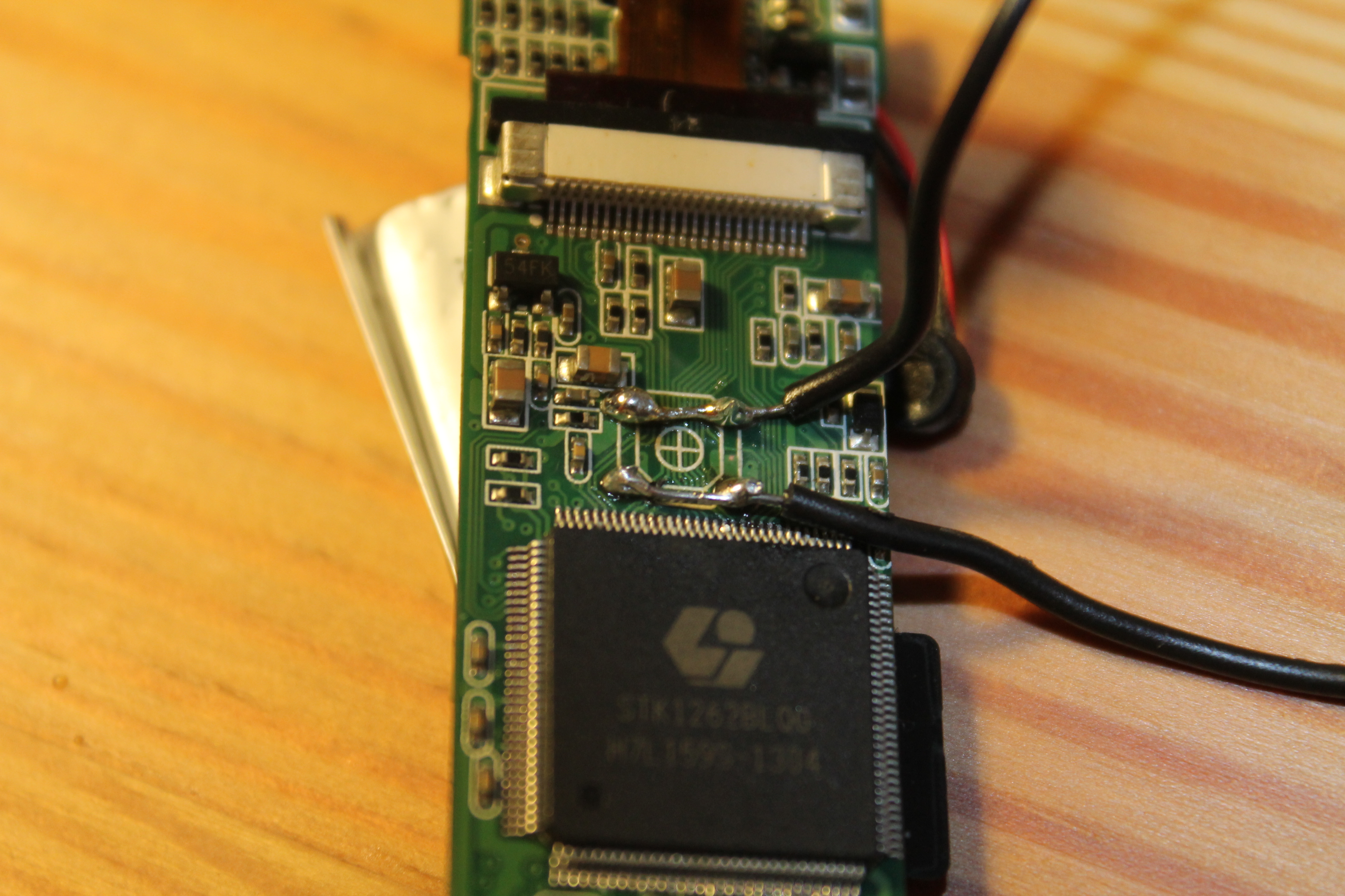

hey peter, i tried to do it with wires but i aint working.
Any idea what i did wrong? its the first time i soldered something and i dont really have a good idea of what i'm doing,but i looked some things up and i think this is the correct way, any idea?
Check how you connect wires on contacts.
You wrongly solder wires.
Additional, this looks very scary :) but dont worry you will make something. Put smaller amount of soldering material, wires should be in contact with PCB only at switch contacts places. Pay attention on nearby capacitor.
Check with ohmmeter what contacts button connects when pressed.

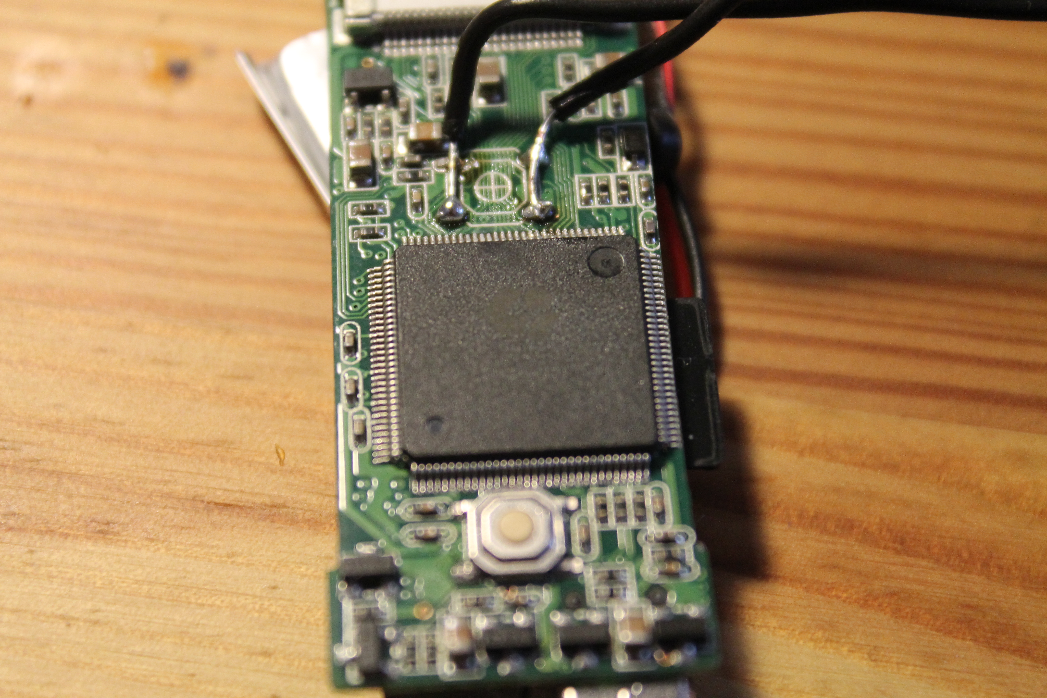

oh ok! so i need to change the wires on the motherboard, from vertical to horizontal and then it should work?
Thanks peter!

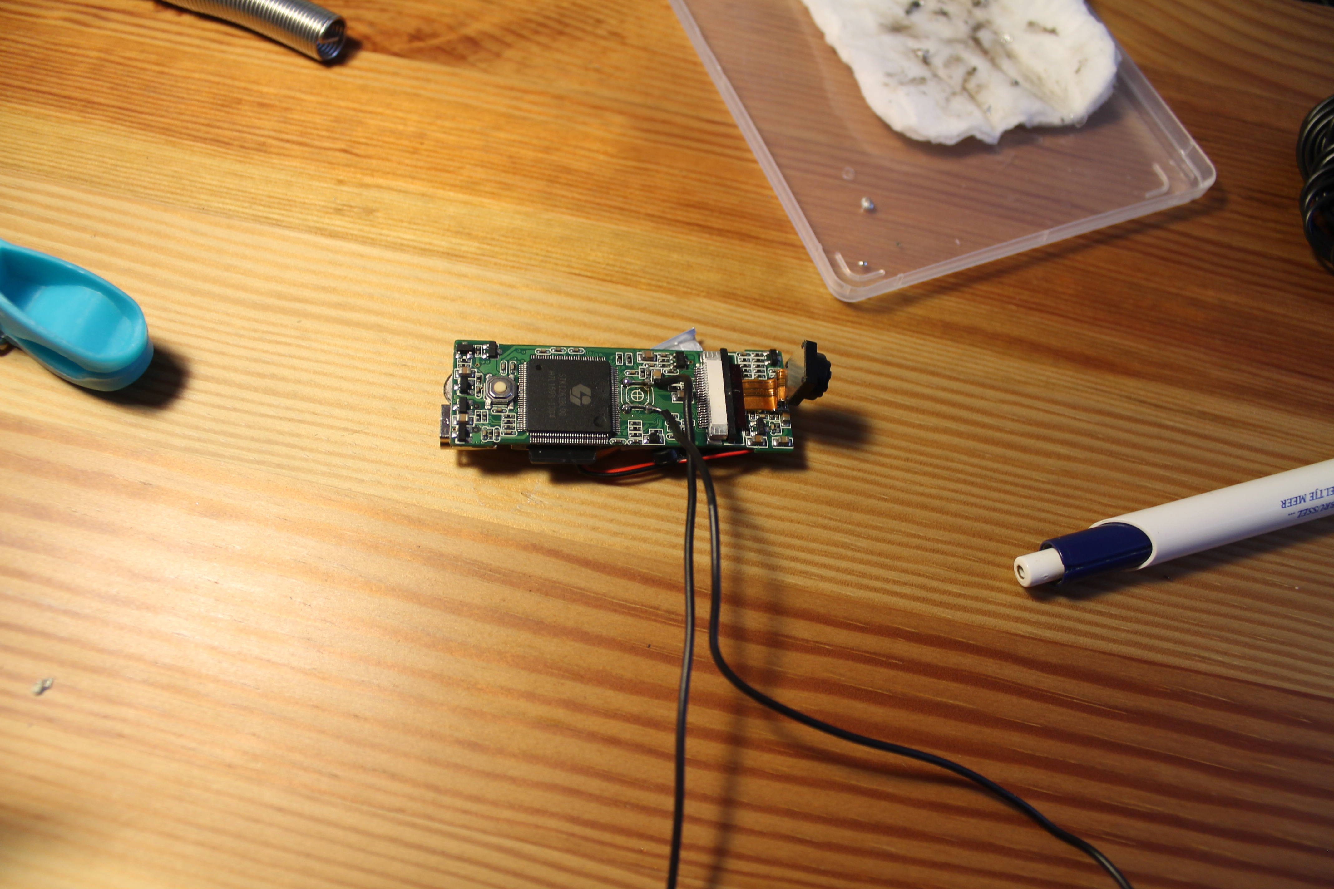

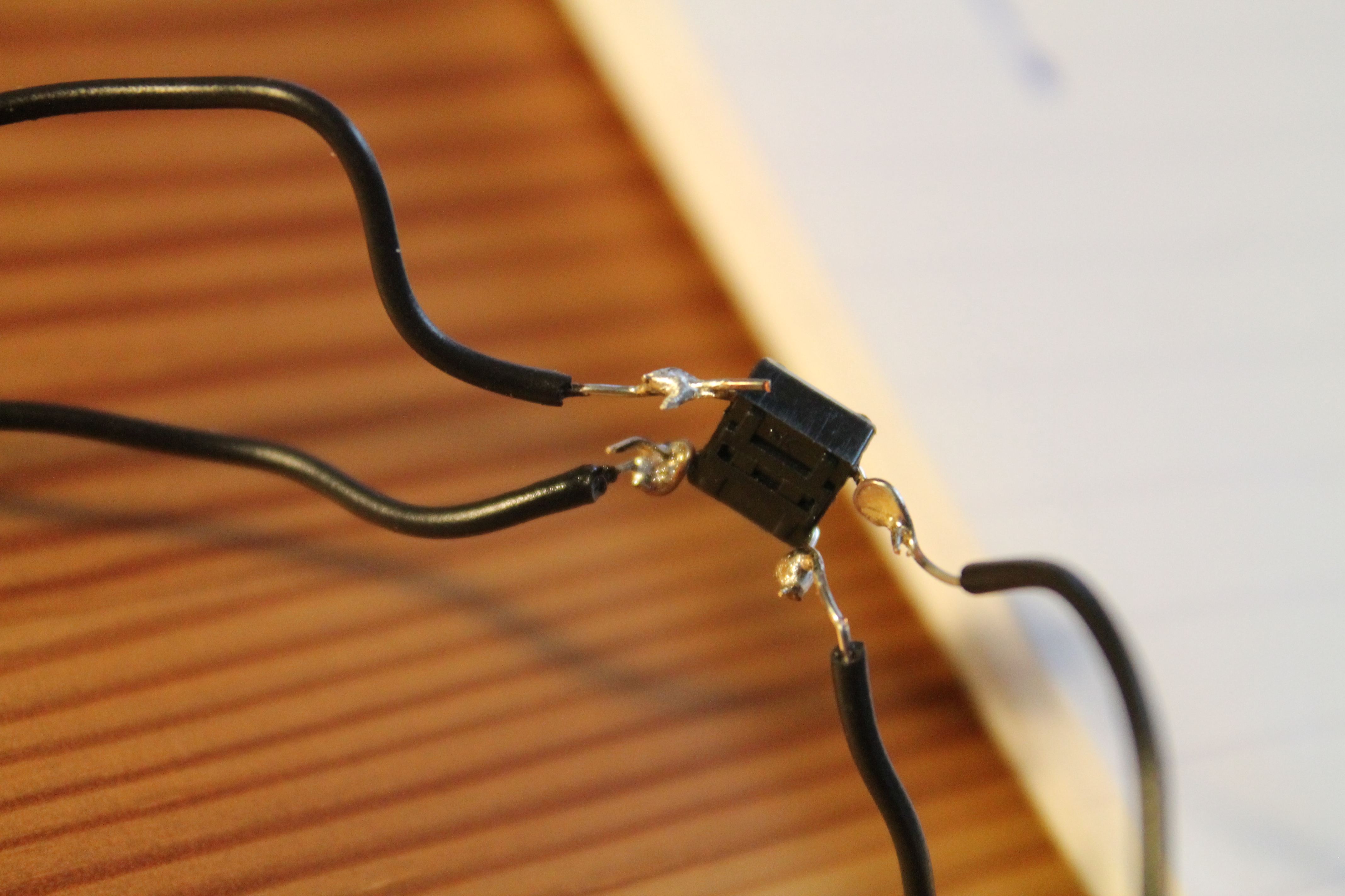

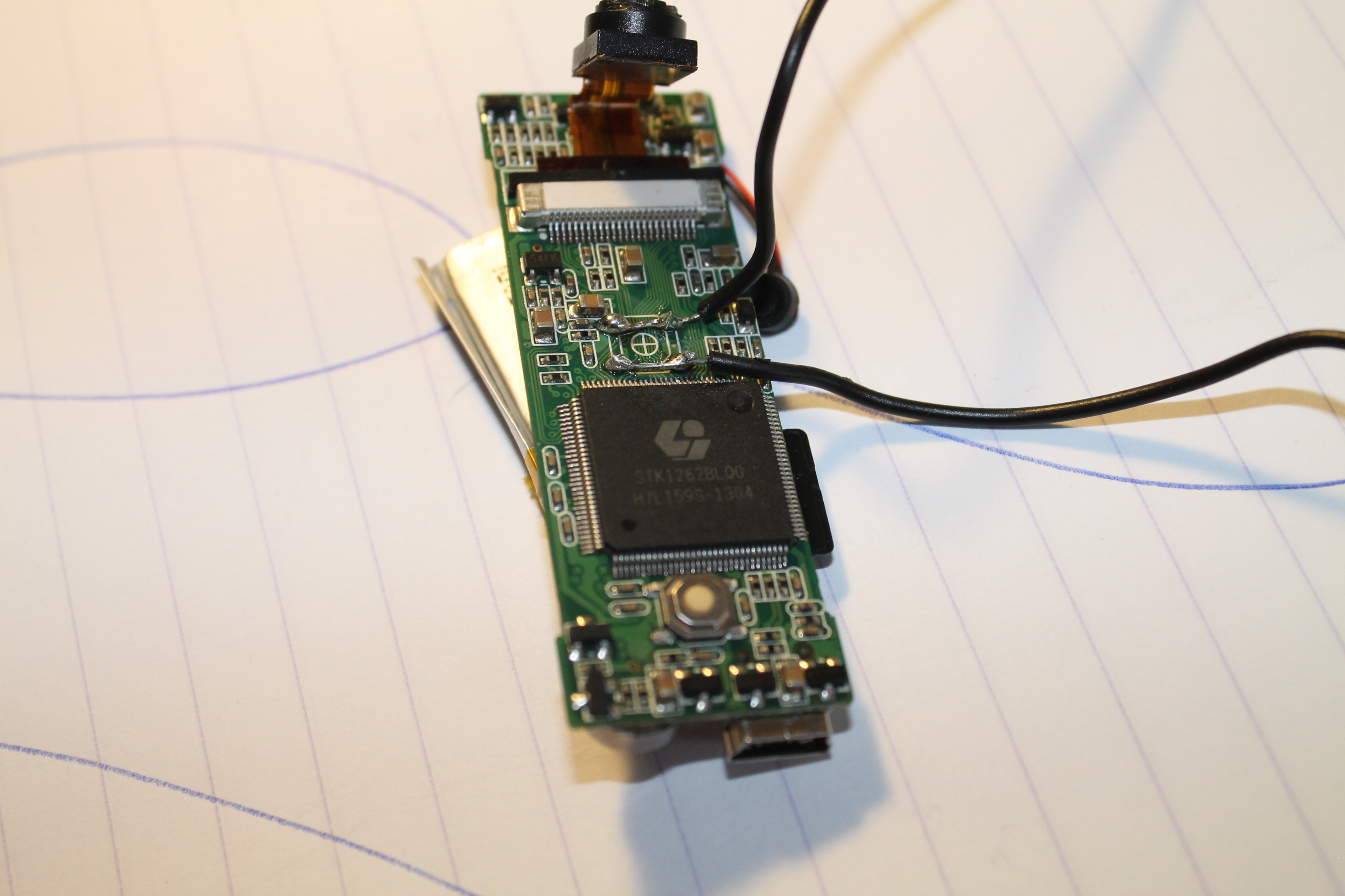

hi peter, i tried to do what you said.
But now the device wont turn on.
The button at the button is to turn the device on. the one i'm working on is take a picture.
Any idea?
Thanks

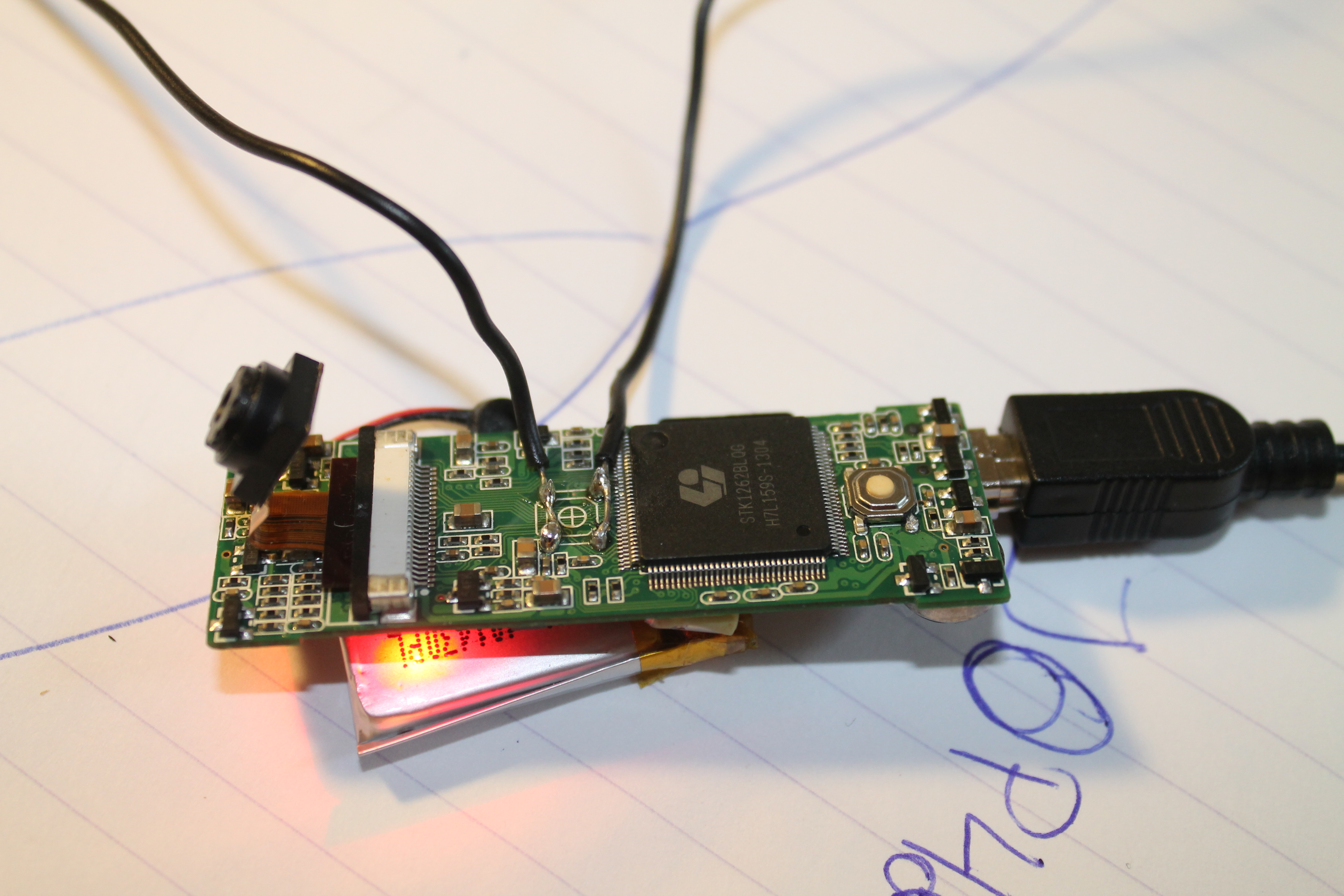

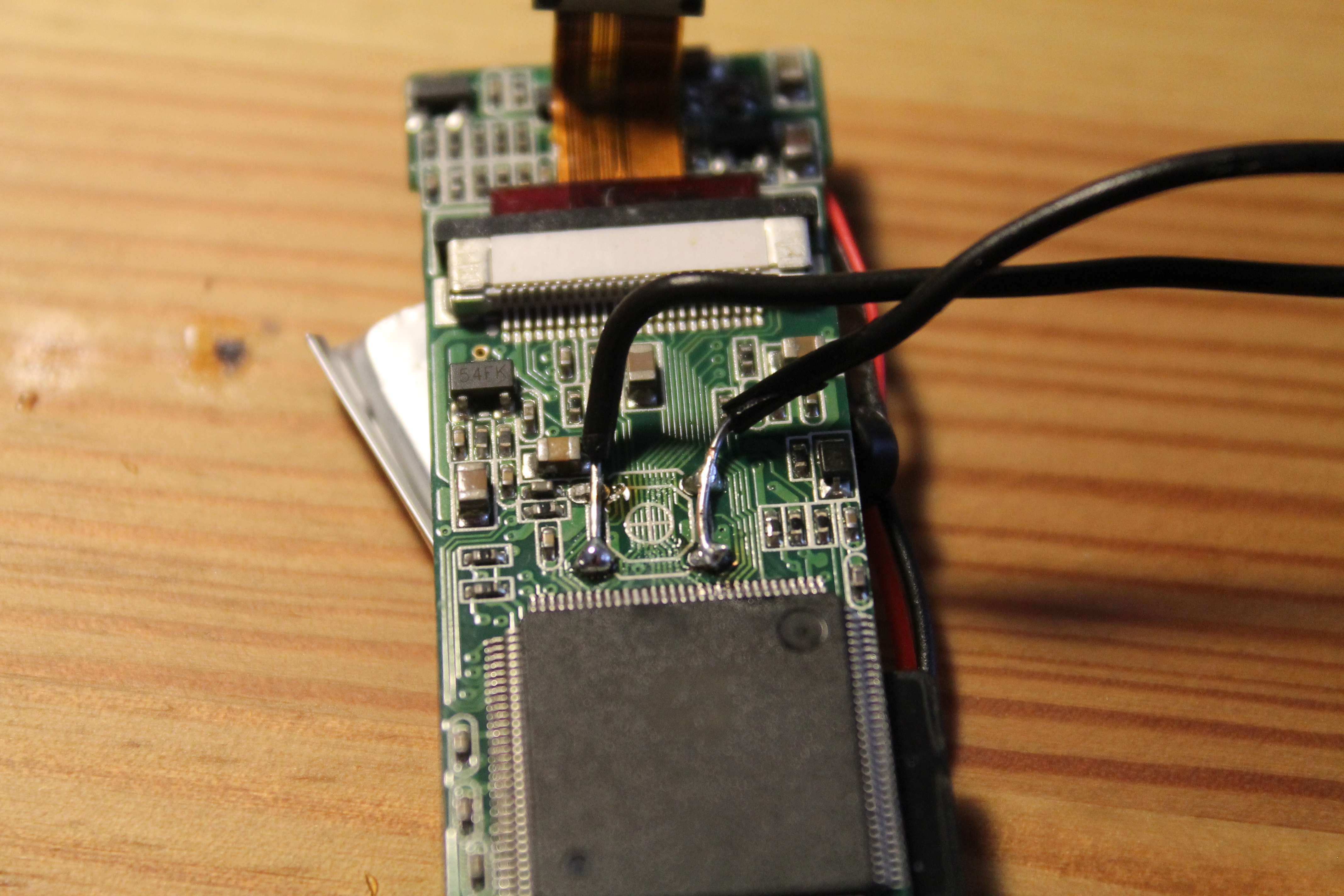

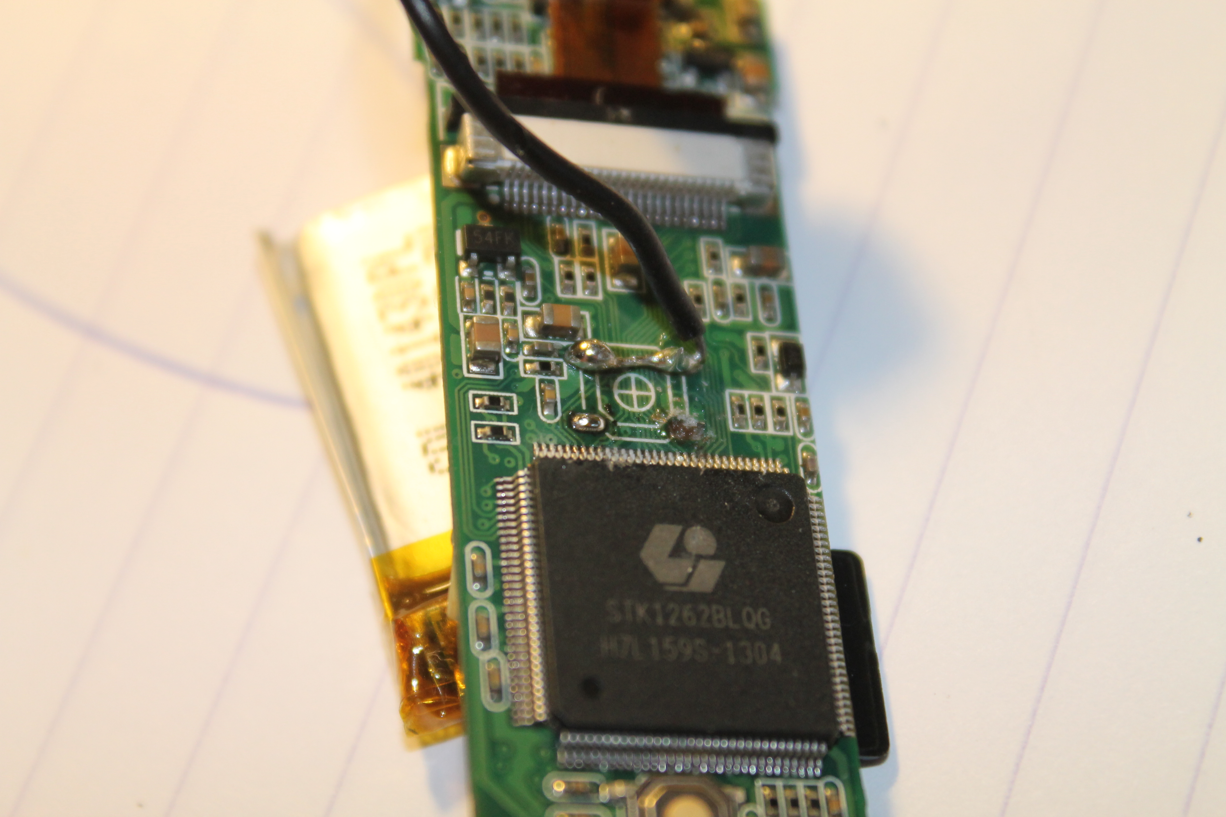

Allright tried some things out. whe i connect them both horizontally it doenst work,
but when i remove one, like on the picture it works, but i obviously cant take a picture
In post #18 illustration in bottom right corner on picture, one wire should be conected on 1 or 2 pins, and second wire should be connected on 3 or 4 pins.
Check with ohm meter that taster what you remove from PCB. Check orientation and contacts of removed taster, check that is the same as pins on mentioned illustration.
Also check second taster what you add on wires, did you connect that taster correctly ?
For picture taster should be pressed once and for video hold taster 2 sec.
Be careful with these contacts on PCB.
Before any next step do what I mention earlier and check to be sure what pins you should connect with wires.
