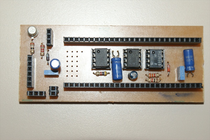

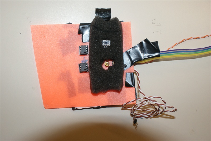

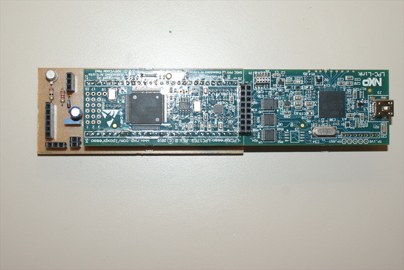

I uploaded some pictures of the setup above. I'm getting the optical signal from a sensor board, the signal is pre-amplified there and goes to the PCB, there it's buffered (leftmost opamp), low-pass filtered (middle) and amplified once more (right) As you see, there are some pins on the PCB, some of which I use for powering the op-amps and the microcontroller. The problem I mentioned occurs when I supply the power from 9V batteries with voltage regulators.
Is there difference between common ground paths when switching from battery power to mains derived power?
I mean changing the position of the ground that goes to the power supply (either battery of mains derived) may result in a piece of ground trace that contains both analog signal return and digital return. Same is valid for the positive supply, a common trace for both analog supply and digital supply may introduce noise.
Are you able to measure the analog input signal directly at the input of the ADC (both signal lead and ground lead as close as possible to the ADC inputs)? You may also measure directly the output of your preamplifier to figure out whether the noise is already present at the output of the preamp. If the signals are clear, then you may blame the ADC's reference voltage.
When measuring small signals close to digital ones, it is best to avoid the use of the probe's ground lead. Better is to connect the coaxial ground of the probe's input directly to the ground of the ADC. Several probes have some additional hardware that you can position over the probe tip to enable a ground connection via very short lead.
Wires between your amplifier and the ADC may pick up noise directly, or via common ground path. I don't know the features of the ADC, but adding a simple RC network directly at the input of the ADC may help. Especially I am thinking of the internal sample rate issue mentioned by FVM.
