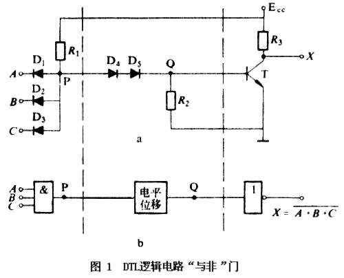

im asking question in regard of my friend
their university master asked them to build multiplexer circuit with diode and transistor sounds they call it DTL logic but my friend do not know how the gates ( and , or , not ) are supposed to be designed with this logic
it should be 2 to 1 multiplexer
can any one give me digram for this multiplexer or at least guide me bout how the gates ( and , or , not ) should be designed with this logic?
he is in urgent need
thanks so much in advance
DTL: diode-transistor logic
and: parallel diodes with their anodes wired together followed by a pull-up circuit. Add signals from their cathnodes, you'll get their "and" result at the anode.
not: a simple common-emitter invertor
or: can be derived from the above two
Hope that helps!

can you give me any schematic of this kind circuit
thanks so much
Tools are not available now. I googled a schematic and posted
it out, hope that helps!
