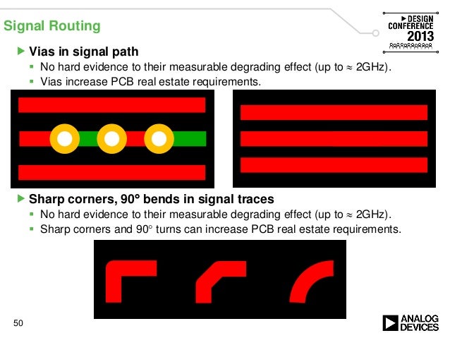

Traces routed in 90 degrees are not well suited to work at much higher frequencies, however RF stages in PCBs are in general confined to a small region of the board, becoming easy to find it.
I wouldn't use them for RF but for std digital you can go into the GHz I believe
If routed with a round D code, the outside corner should be smooth with same diameter.
If routed with a square D code, the corner will be sharp and produce higher e-field leakage due to sharp gradient but only significant at UHF + to nearby traces.
It may also affect S parameters slightly for Controlled impedance with change in width and more likely above 2GHz.
high-speed-and-rf-design-considerations

When Gerber File is created, the routing is done with round D-codes as selected by trace width in layout package.
Did you see my report link? https://image.slidesharecdn.com/ve1...onsiderations-ve2013-45-638.jpg?cb=1379322252
Yes but Gerber never draws with a square aperture, only round apertures are used for draws. Round and square and any other shape can be used for flashes (pads etc.). I was referring to your comment about routes done with a square aperture.
