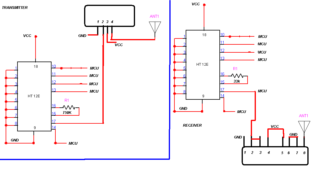

please give me guide for this work.
programming and H/w side.
this h/w diagram i am using. is it correct.
i am confuse on 14 no. pin of both encoder and decoder.
Hi
pin 14 is "Transmission enable, active low", try to go through the datasheet.
you can download the datasheet from https://www.futurlec.com/Others/HT12E.shtml
I have not studied the datasheet in detail but it seems your circuit may be incomplete. :!:
Everything correct, you can do low or high on pin 14 using your code
still it is not working
