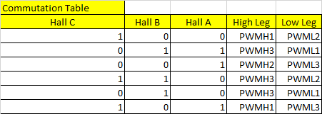

Commutation table using Hall sensors
I did some effort to finally create a Commutation table to drive using Hall sensors. The waveform i found from the motor data sheet is as follows
I have taken the commutation table switches where the sine wave is maximum and minimum. Please help if it is correct or wrong which will help to start programming. I have attached the data sheet of the motor and the hardware board schematic.

I presume that the Hall sensors will be used for speed and direction
the hall sensors are for block commutation... this is the simple method to make the BLDC motor run.
Klaus
Just to get some confidence and see the motor rotating, i want to start with hall sensors. Then i want to go for sine commutation. Only doubt i have is why at the peak of sine wave should i take the switch information.
Re: Commutation table using Hall sensors
Your data and graphs are correct; but you should use the transition to sync the sine waves. By the way, you are using a table to drive a PWM to synthesise the sinewave, right?
You need to take care while starting up (because you will need to ramp up the frequency slowly) and shutting down.
You can now run the motor to a accuracy of given rpm +/-1 because of sync problems. You can position the rotor using the encoder with a high degree of accuracy.
No. As i first step i will read the hall sensor values and just switch the legs.
As a first step i don't want to use encoder signals.
Yes it is inefficient but it will help me to see if i am programming properly and the motor is running. Any advise how to proceed.
