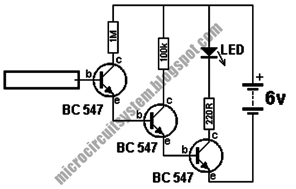

I am thinking of such a circuit https://4.bp.blogspot.com/_E1J8eYvr...FE/JmPIaLYbGio/w1200-h630-p-nu/Untitled-1.jpg in combination with an LDR instead of the 2.2M feedback resistor in my audio amplifier. It might do the trick?

The circuit with the three transistors is able to light up a LED from the static of a hand near it (not touching), so it is quite sensitive. But I think it responds to AC, so there will be LED fluctuations that the aye can't see. So somewhere the AC input must be converted to DC. Where shall I do this?
* The PVT412 is great! It is just my persistence of using discrete components (you do not need to order anything) where I can that makes me not want this.
