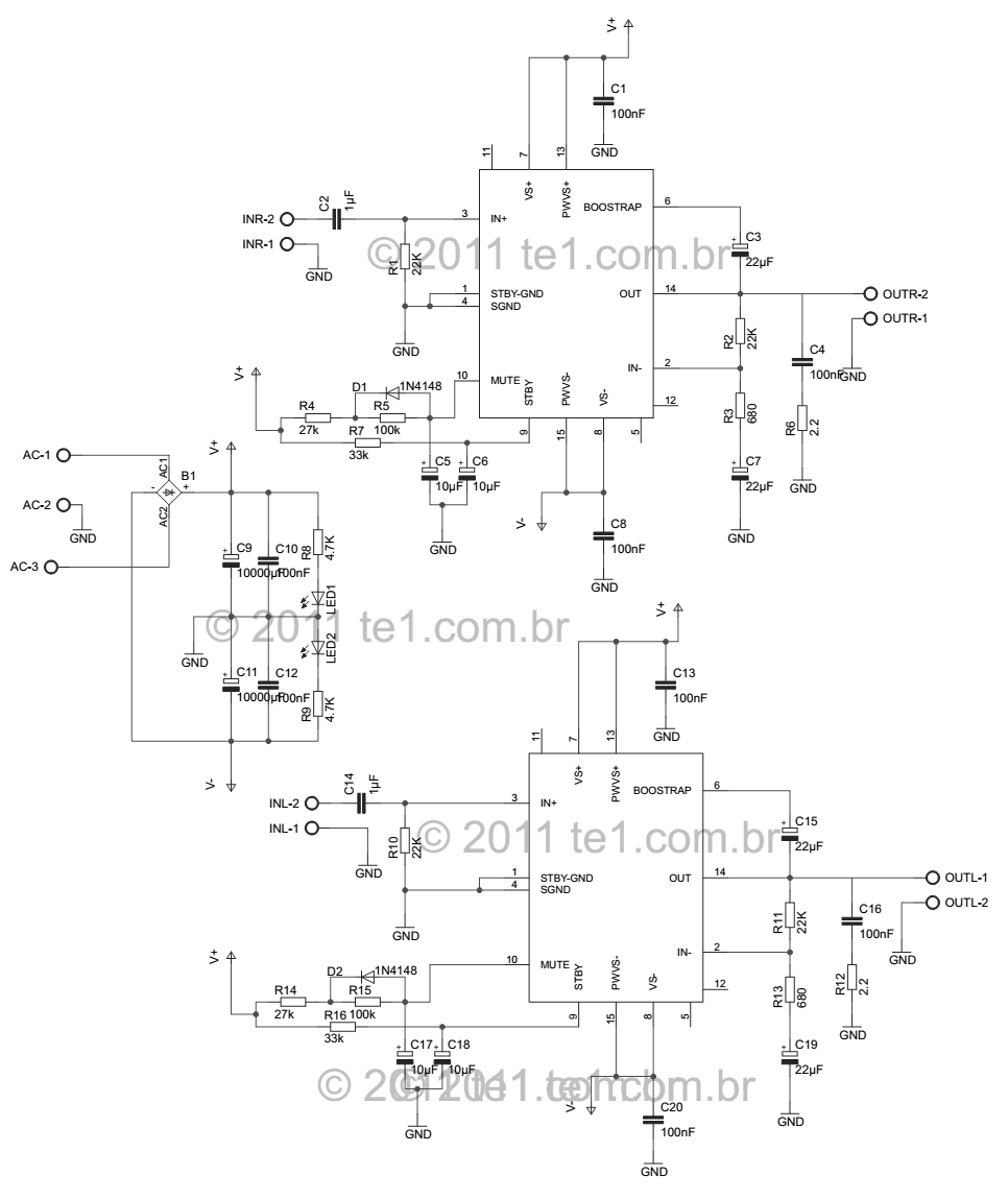

I build amplifiers as my hobby when I come in from work I am yet to build good high power amplifiers but what seems to e worst is that I can never build good amplifiers they always hum or hist or if not they always make the amplifier that its connected to lower, If its not lower then it never increases the volume so I am always trying out new circuit I want to know how does this circuit look to you guys, the plan would be to use it to increase the volume then use a tone control circuit otherwise to control bass, mid and tweeter.
want to add it to this circuit
The first is a very basic circuit, maybe from the 70ies.
The second - as already remarked in another thread - is useless because the amplifier partname is missing.

The power amplifier you showed here is probably the TDA7293 you showed in another thread. Its part number and its supply voltages should be shown on your schematic. Its datasheet tells you that the ratio of R2 and R3 set its voltage gain then it is easy to increase its gain with those resistors instead of adding an old preamp circuit.
Thanks for that info so you think that increasing the gain from the chip amp itself is sufficient? Also I need tone control with each circuit I build so I would still need to add that but I wouldn't want it to reduce the overall gain too much or at all I dont know any good schematics really.

The TDA7293 amplifier in the datasheet has a voltage gain of 33.5 times which is more than most amplifiers. Why is the level of your signal source so low?
A tone controls circuit usually has a voltage gain of 1 (no gain and no loss) so that it can boost or cut highs and lows by up to 3.5 times.

Of course there is a limit to resistor values. R3 is 22k now. If it is increased then the gain will be more. 47k= double the gain. 68k= 3 times the gain. 91k= 4 times the gain.
Also make R1 the same value as R3.

R3 can be much higher than 91k but when the gain is increased then the distortion and noise are also increased.
R2 is in series with capacitor C2 to ground. If the value of R2 is reduced to increase the gain then the value pf C2 needs to be increased so that the amplifier amplifies low frequencies.
The datasheet has Application Suggestions that lists the suggested values on the schematic, the function of each part and what happens if its value is larger and what happens if its value is smaller.
The TDA7293 has Clip Detection that is not available on the TDA7294.

I was thinking about trying the clip light feature, would I just connect a led to pin 5? anode to pin 5 and probably a 1k resistor from cathode to ground
It seems that you do not look at and read the datasheet.
The schematic of the amplifier IC shows an N-channel Mosfet with its source at ground and its drain at pin 5. The Electrical Characteristics says that the clip detector pin 5 should have a 10k resistor to +5V (for it to send a logic low to an alarm circuit). No LED. The maximum allowed voltage at pin 5 can be +120V but they forgot to say its maximum allowed current. The 10k resistor from pin 5 to +5V will have a current of only 0.5mA so if you put a 1.8V red LED in series with a 75k resistor to +40V for a current of only 0.5mA then the LED will be very dim. The datasheet says that the duty cycle of the clip detector is low so it will make the LED appear even dimmer.
Maybe pin 5 will survive a current of 20mA then a resistor in series with the LED to +40V can be 2K but the heating in the resistor will be 0.73W so a 1W or 2W resistor should be used.

I actually build the TDa7293 amplifier in stereo and I increased the gain I increased R1 and R3 b using 100k resistors.
Your gain is too high for a power amplifier. For that much gain you should use an additional preamp so that the power amplifier has enough negative feedback to reduce its distortion and noise. The very high gain of the power amp also reduces its high frequency response. What is your signal source for its output level to be so low?

The datasheet says the minimum input resistance of the TDA7293 is 100k ohms and you have a 100k resistor R1 parallel to the input so the input resistance of your amplifier is 50k ohms.
