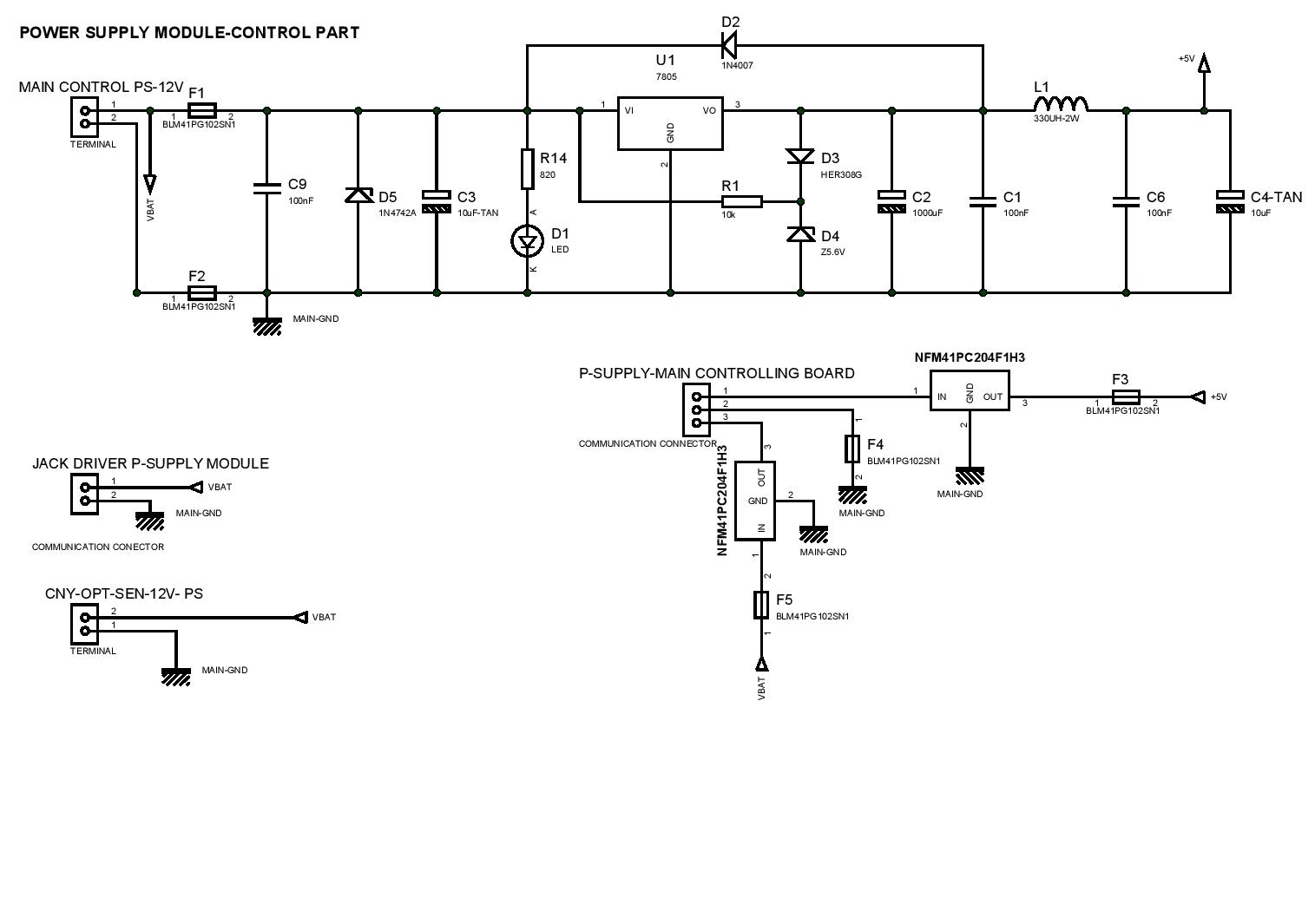

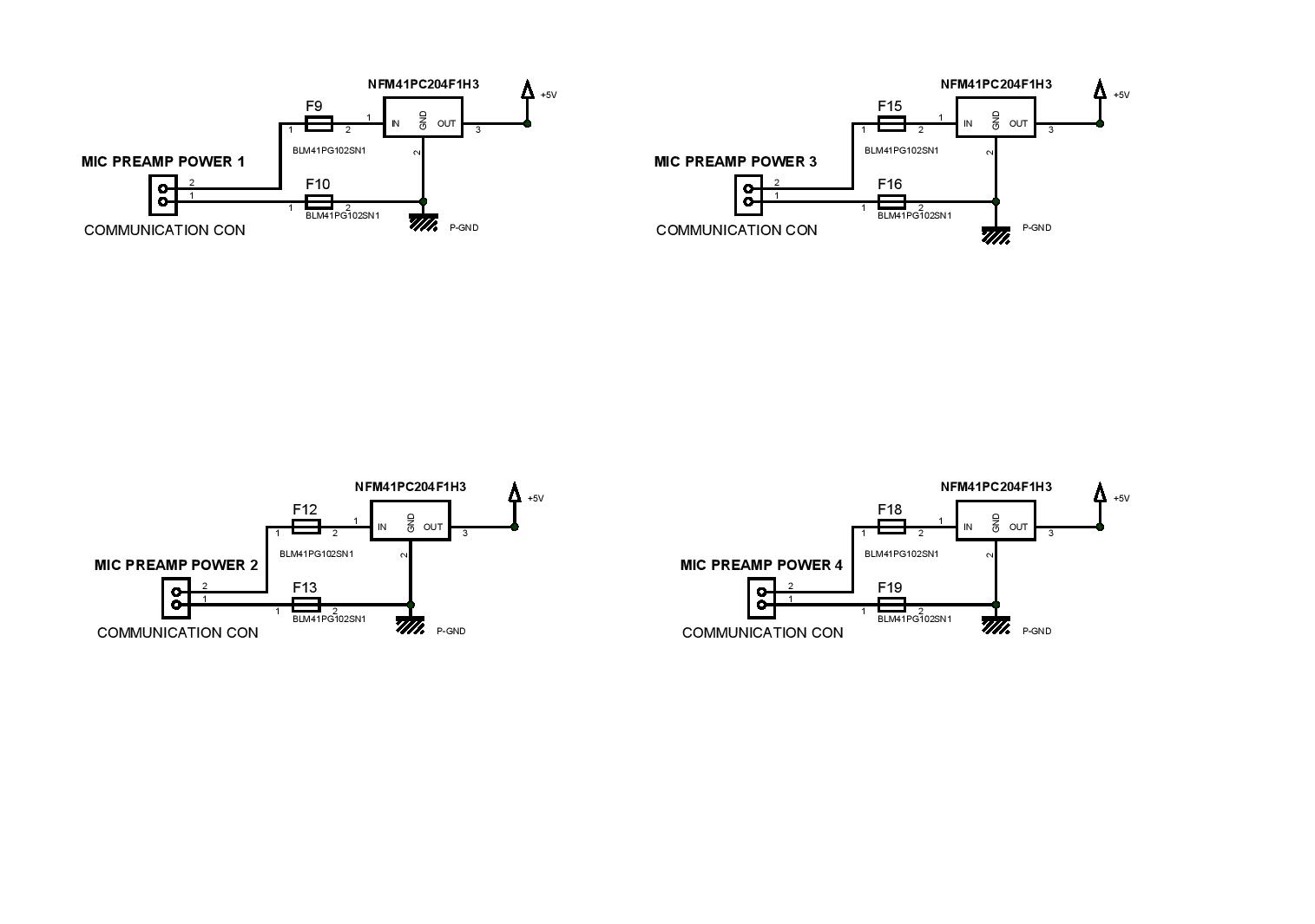

You are right! but I think I have considered all the things as you said, but for being sure I put my power supply schematic for you to check it please. my device is an industrial machine with a fairly big size. as you see . https://obrazki.elektroda.pl/4684567500_1447403196.jpg
It has two metal wire cages (one for recognition part and another for controlling part) the machine has several actuator like several pneumatic jack dc motor and also has 3 single phase motor (start/run capacitor type)
actually these motors make faults in my system ...

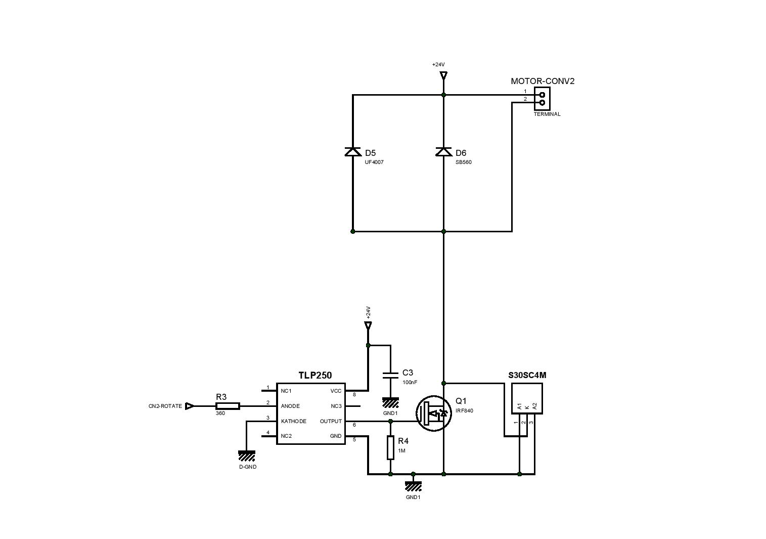

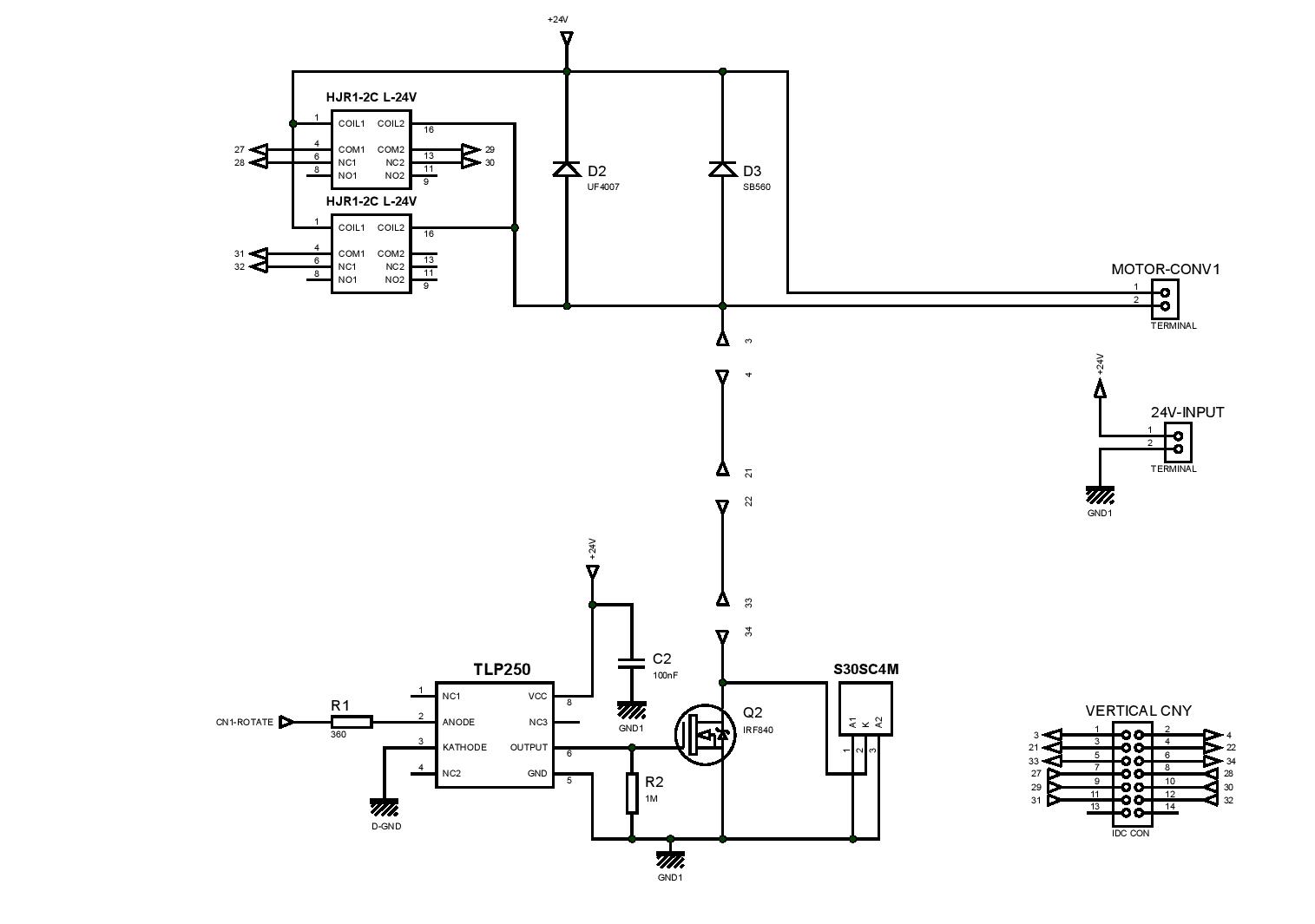

these are controlled by contactor with controlling board as below schematic:
https://obrazki.elektroda.pl/4550416500_1447406699.jpg
https://obrazki.elektroda.pl/5146439700_1447406745.jpg
https://obrazki.elektroda.pl/4570439800_1447406803.jpg
in page 1:
there are entrance connectors. 24v for contactors & 12v (vbat1) for opto sensors (IR)
AND SOME SIGNALS TO/FROM MICROCONTROLLER THAT ARE ISOLATED BY TLP250 or separated power supply.
PAGE 2 AND 3 ARE DRIVERS FOR MOTOR'S CONTACTOR.I should explain about relays.they are safekeeping relay that prevent to active several part of machine together in error time of controllers or manually activation, illegaly.
as you see, some normaly close relay's contactors put in series with driver from another parts(another boards).

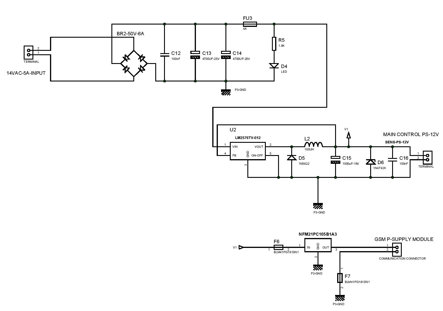

NOW IT IS NECESSARY TO CHECK POWER SUPPLY BOARDS:

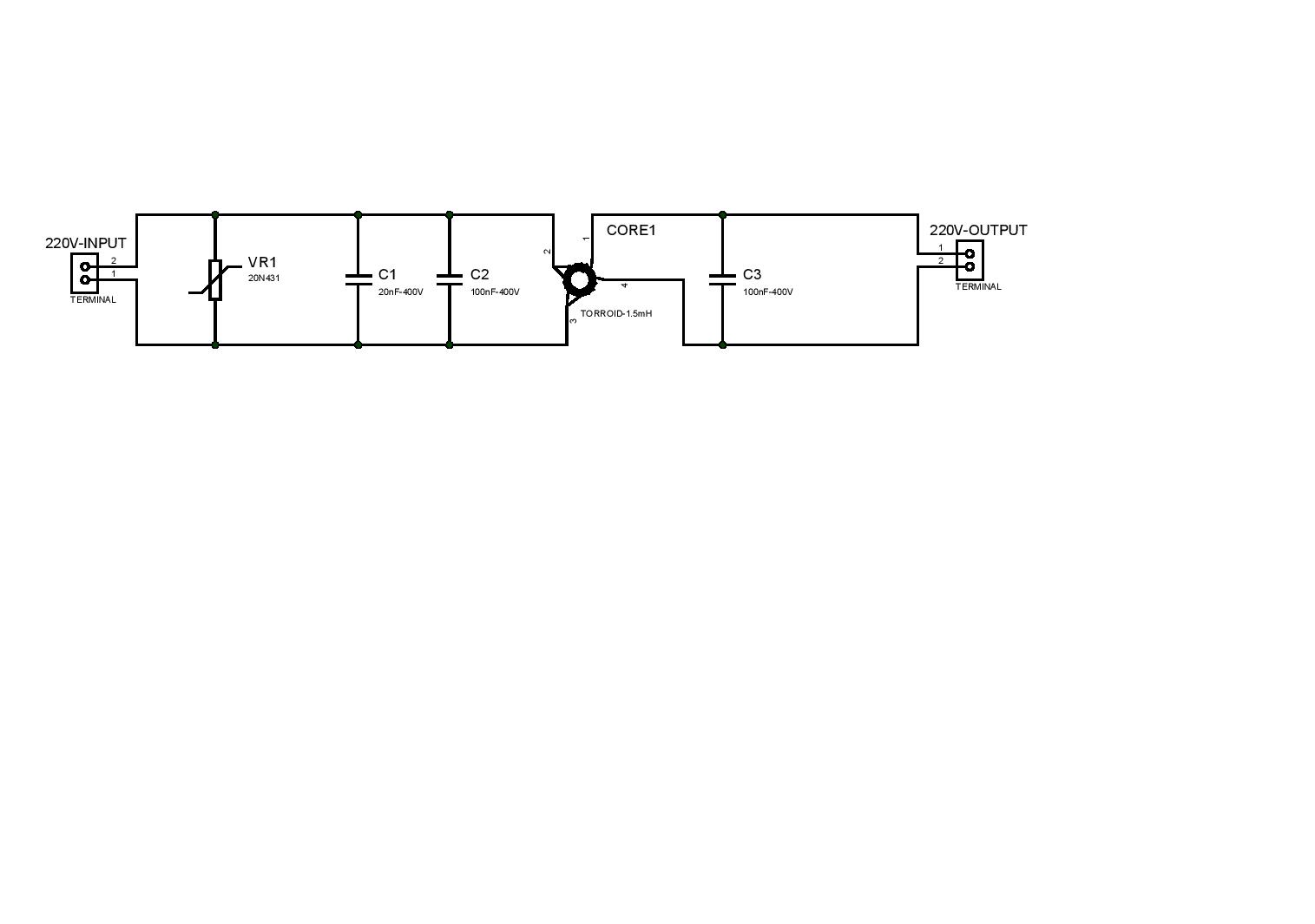

At the first, AC Power Line pass from line filter as below:
https://obrazki.elektroda.pl/2783082600_1447410688.jpg

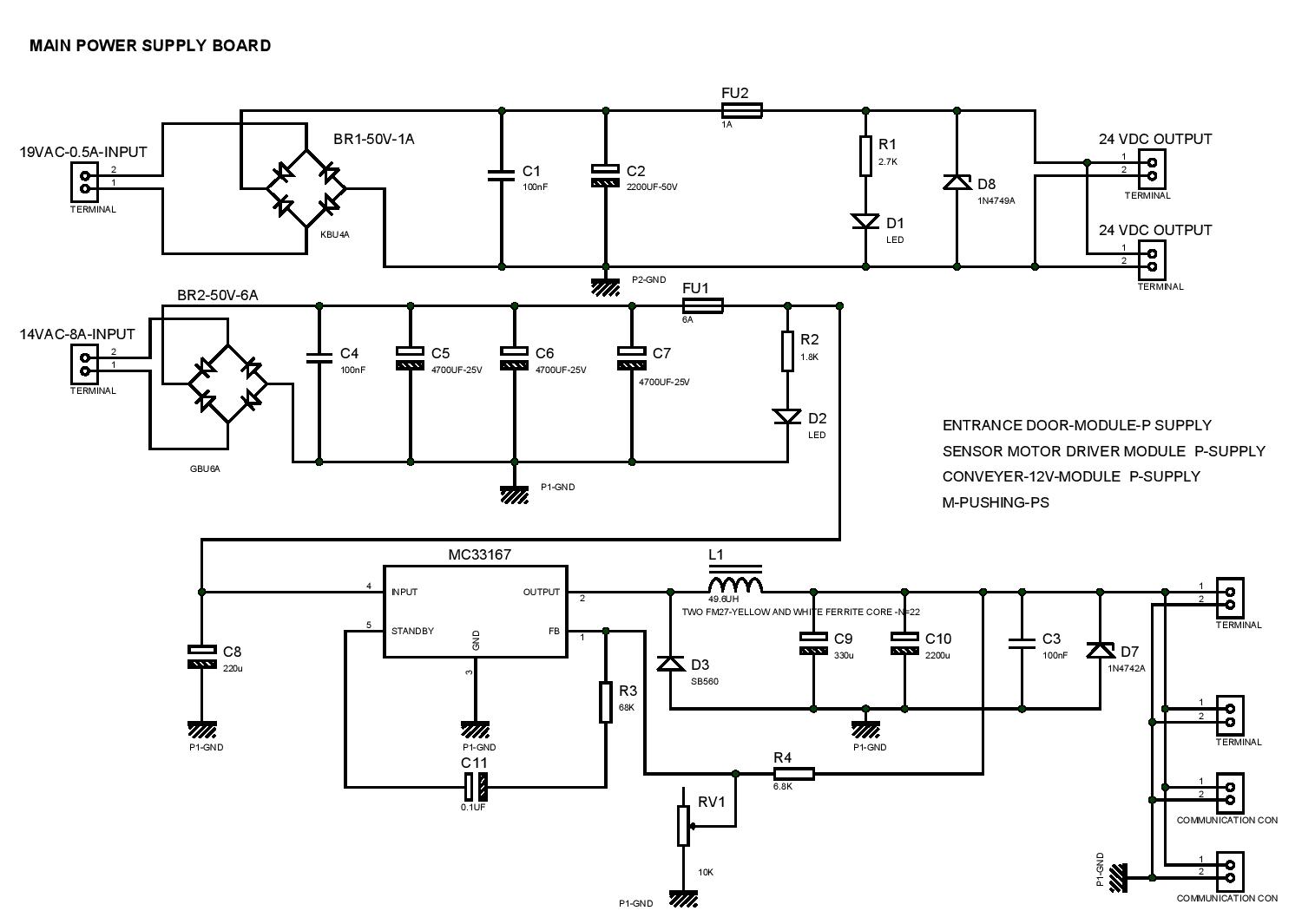

then goes to MAIN POWER SUPPLY BOARD THAT PROVIDES ALL VOLTAGES IN DEMAND :
https://obrazki.elektroda.pl/5658890900_1447408290.jpg
https://obrazki.elektroda.pl/3745015900_1447408330.jpg
as you see, there is 3 separated input transformer and output terminal voltage .

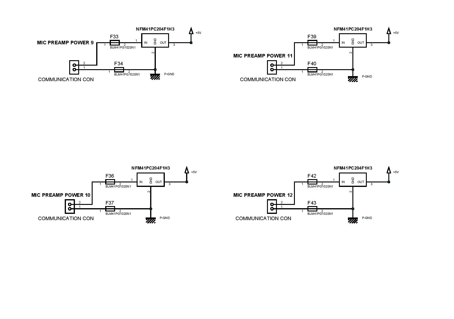

AND TWO ANOTHER POWER SUPPLY BOARDS THAT ARE DERIVERD FROM THIS BOARD .
THESE ARE PROVIDE FINAL VOLTAGE FOR MICROCONTROLEERS :
1- https://obrazki.elektroda.pl/9646797200_1447408950.jpg
2-
https://obrazki.elektroda.pl/1507475000_1447409109.jpg
https://obrazki.elektroda.pl/2140322800_1447409155.jpg
https://obrazki.elektroda.pl/1262136100_1447409183.jpg
https://obrazki.elektroda.pl/9270926600_1447409221.jpg
In general,I attempt to separate noisy part from beginning and I connected with optocoupler to these noisy parts in all parts of circuits and now surprising thing is that both Ac power line of machine and DC power output of machine's DC power supply are noisy in swiching time of motors !!!! as I said before,I receive interrupt from ac power line of machine(Ac plug) when stm32f4-discovery board is connected to a laptob through an adaptor !!!
thanks.
also I should say all the boards are isolated from metal wire cages and because of some limitations ,there is no earth !
THANK YOU. I CONSIDERED ALL OF THEM BEFORE BUT I CHECKED IT AGAIN.... :sad:
YOu need an earth at least coupled by RF caps on all sensitive boards or really excellent shielding and CM chokes , which by the way I did not see anywhere only single ended ferrite.
The big problem is ground shift.
Stimulate disturbances with a plastic cap discharge on NEutral to ground using LiPo battery multivibrator method or Loop antenna. anddo same with scope probe ( large loop short) to act as antenna to monitor influence.
If you have a bag of CM chokes, that would be an easy start and PU or PE Plastic Film ultra low ESR Caps for Connecting grounds using flexible copper conduit (think plumbing) this prevents DC or line ground faults.
think of it this way..
If you have a 1kV line transient and tolerate 1V on the Reset line or ground shift with logic. you need 60dB CM attenuation at 1 MHz approx., I would go for 100dB CM rejection of 1MHz injected on the line. as impulses.
Reactions: MB.ESK
