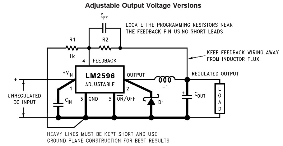

I was suggested of using two switching voltage regulator circuits (maybe based on the LM2596-ADJ like *this one*, or other ICs) on the splitted voltage lines. It would allow to regulate the output voltage on each line so I could achieve a different dual supply voltage (e.g. 9-0-9 or even 8-0-12 but I'm not sure I'll ever use asymmetric voltage).
Will this be of any trouble to the rail splitter?

If you are going to the trouble of adding two switching regulators, then why not supply them with separate isolated voltages and you won't have to mess with a virtual ground circuit?

As said, it doesn't look like a good design idea. I would feed a buck converter and an inverting buck-boost converter by the 24 V source to make a dual supply.

that an inverting buck configuration is heavily limited in the amount of output current (a few hundred mA, certainly not 1A) or at least, the designs we've considered were limited.
Certainly there are numerous inverting buck converters that can deliver more than 1A, although they may require an external MOSFET for that current.
You may also remember that an inverting buck configuration is heavily limited in the amount of output current (a few hundred mA, certainly not 1A) or at least, the designs we've considered were limited.
The topology isn't limited of course. Your split supply + switched mode supply idea involves a negative buck converter for the neative rail. I could also argue that there are no suitable negative buck converters avaible.
