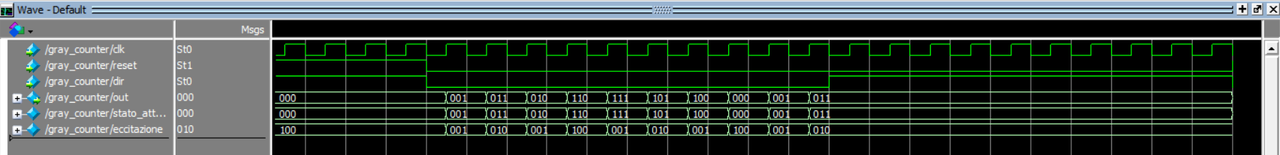

I need help to create a 3-bit Gray code counter that can count both forwards and backwards. Using flip-flops as memory, I was able to create a counter but only in one direction. The dir signal, despite changing, cannot reverse the counting direction. The flip-flop needs to have the same value as input to change the exit. I noticed that the counter counts only in the direction it is in at the time of the reset. When dir = 0 it should count from 0 to 7 and when dir = 1 from 7 to 0. I do not waant to change the flipflop.
This is the simulation:
This is the verilog code:

You can modify your code like this:

Thanks for the idea, but I wanted to keep the flip-flops, as it was an exercise to create a counter using the given flip-flop as the memory cell. The logic is correct, it's just a problem of Verilog syntax. The counter simply stops working when the dir signal changes and I need help fixing it.
I've seen counting go downward when taking output from Q pin of D flip-flops. To count upward I find I must take output from bar-Q pins.
What do you mean?
My flipflop exit are stato_attuale[], and my inputs for the flipflops based on the output are eccitazione[]
Well, then, I guess you've just invented Schroedinger's logic, it works and doesn't work at the same time!
I'm assuming my logic is correct, I think this is just a verilog syntax problem
What does this mean? You expect a Verilog compiler
Then I guess my logic is wrong... but I don't know where. My counter stops when dir changes value and I don't know why
Your so-called "flip-flop" code is garbage. It neither models an edge triggered nor level triggered flip-flop correctly.

The @(posedge C) construct is right for edge triggered logic. But then C must not appear in the edge sensitive logic expression.
Simpled edge triggered FF

Thank you man, I wanted to remain the closest possible to this flipflop (it was an exercise):
module FF(X,C,R,Z);
input X,C,R;
output Z;
wire y1,y2;
assign y1=(~y2&C&X) | (y1&(~C|~y2));
assign y2=y1^C;
assign Z = y1;
endmodule
Can I still work with this flipflop?

endmodule
module FF(
    input X, C, R,
    output Z
    reg y1, y2;
    always @(posedge C or posedge R) begin
        if (R) begin
            y1 <= 1'b0;
            y2 <= 1'b0;
        end else begin
            y1 <= (~y2 & C & X) | (y1 & (~C | ~y2));
            y2 <= y1 ^ C;
        end
    end
    assign Z = y1;
endmodule
I think I've found the error, basically the counter should change value everytime the clk change, but I have posedge C and non posedge clk. The time that at least one of the input of ff does not change from 0 to 1 the counter stops, as there is not a posedge C that rule the flipflop.
Usually (binary) counters change state on one clock edge only. Not on both edges.
Klaus
What do you mean?
Posedge triggered versus negedge triggered is what I was getting at. By experimenting with my simulations of counters, the scope traces indicate that changes of state depend on whether polarities are one way or the opposite way. In other words, whether positive edge triggered or negative edge triggered. It has to do with Q versus not-Q outputs.
I saw there were 4 different combinations regarding whether Q or not-Q (bar-Q) feeds the following flip-flop. Also whether to take readouts from Q or not-Q. It also makes a difference how you use D FF's or JK FF's. I think that makes 8 different combinations to test.
