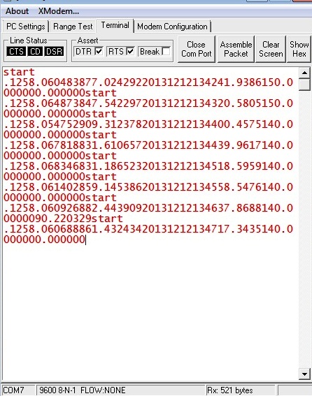

I have fixed extractdata() and ISR related code.
Mention the AVR you are using and also Fosc and baudrate. I will write a code for you. .hex file attached.

getting o/p like this
I mean i wished to separate the string
https://obrazki.elektroda.pl/8248537800_1386857502.jpg
<a title="Untitled.jpg" href="http://obrazki.elektroda.pl/8248537800_1386857502.jpg"><img src="http://obrazki.elektroda.pl/8248537800_1386857502_thumb.jpg" alt="Untitled.jpg" /></a>
