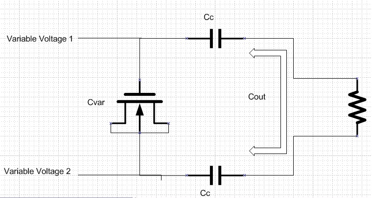

I am going to use the MOScap in a structure that its schematic is attached. the voltage of both terminals of MOScap(G,S/D/B) is changed. certainly, the capacitance is not just Cgate, because the capacitance of MOScap depends on Vgate and Vsource not just Vgs (gate - source voltage)! so all charts in documents shift up or down if dc voltage is applied to S/D/B terminals and also a capacitance is seen in S/D/B terminals which is different from Cgate. although, i think that these 2 capacitances should be the same, they are not the same in my simulations. what's your opinion?! am i right?!do you think that the capacitance of D/S/B terminals are as important as Cgate?!

... do you think that the capacitance of D/S/B terminals are as important as Cgate?!
If you got the single capacitances (Cgs, Cgd, Cgb) from a preLayout analysis: these caps are derived from the (MOSFET) model, and are calculated including their voltage dependency.
If you got them after a postLayout analysis, then possibly additional parasitic caps are included, which may -- or may not -- have been calculated including their voltage dependencies, depending on your extractor setUp.
In any case, all these caps have to be added in order to get the real capacitance value.
The easiest way to get the total capacitance between the 2 cap nodes is to inject a (unit) current source between the 2 nodes, then run an AC analysis and plot the cap's impedance (= cap voltage, because Ω≘V (or MΩ≘MV) for unit current = 1A) vs. frequency.
