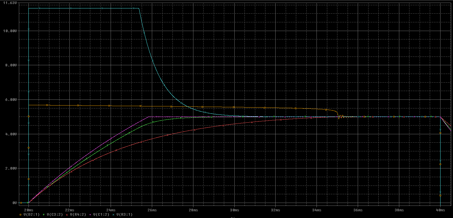

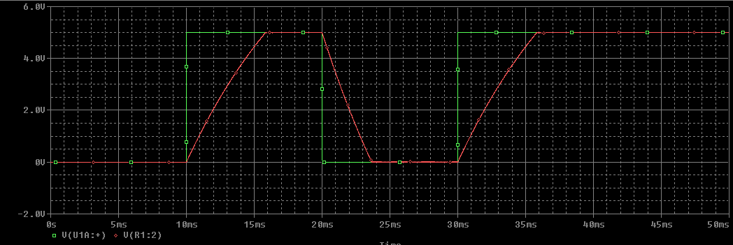

This circuit shows the input switching on and off and the voltage on the capacitor ramping up and down, exactly what is expected. As the capacitor and resistor would form a low pass filter with a relatively low cut off frequenct, I would not expect to see any ringing.
Frank

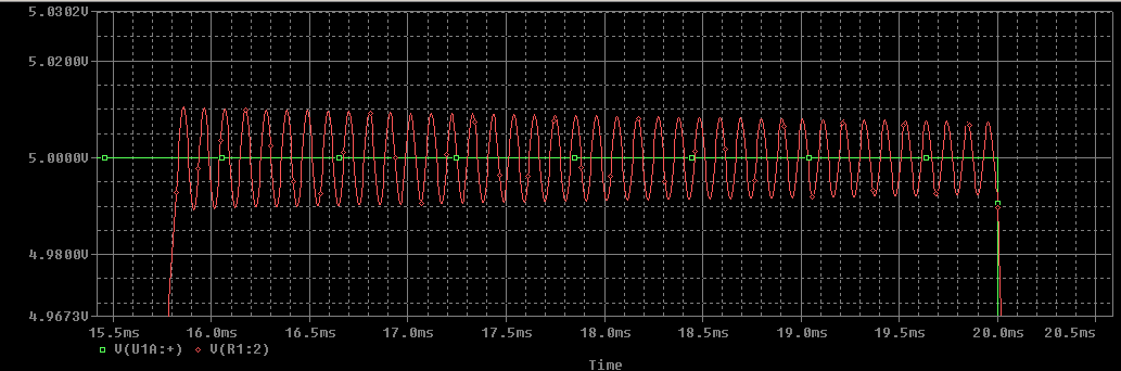

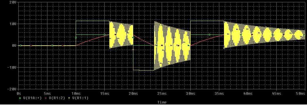

You can see the ringing in the color changes or by inspecting op amp output but here it is in PSpice:

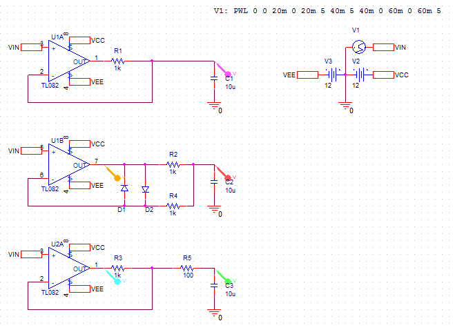

Circuit:
Overview:
Op amp output in yellow:
Detail @ 5V:
The ringing makes sense to me because the op amp output initially overshoots, then when the capacitor approaches the target voltage it overcharges before output drops, and the op amp output falls low, and that cycle repeats. The low filter cutoff is the reason for the ringing because of the longer delay times. Lower cutoff (e.g. larger capacitor) actually leads to higher magnitude ringing.
Try putting a 10 ohm resistor inline with the capacitor. That restores proper response (shown as a single stable color transition at the output of the op amp).
Notice if you use a 1 ohm resistance, the ringing returns (seen as rapid flashing red and green at the output).
The ringing we see is because the simulator exaggerates a tiny discrepancy in response among the various components, from one iteration to the next. (Falstad's simulator is not alone in having limitations.) This is likely where we put a plain capacitor adjacent to plain wires, often bringing out such jittery response in a simulator.
Come to think of it, the ringing we see could in fact be occuring in real life, but at a speed of femtoseconds, much more quickly than the eye can see. Hence the time needed for node levels to settle is usually transient and of little consequence.
A simulator, however, due to calculating from one discrete step to the next, might generate these real behaviors artificially, yet distort their timeframe, and their influence.

Before I saw any replies here I tried a different circuit. I figured it might help to not let the op amp output go quite as far past the target voltage, so I added some diodes, the center circuit below:
This also cleaned up the output but not as cleanly as simply adding a resistor (op amp output = orange, capacitor voltage = red -- the resistor circuit is blue/green by comparison):
When I did this, I thought the circuit looked familiar, then I remembered seeing the same set up in a sample-and-hold circuit I was looking at a few days ago:
My question is: If the issue with the ringing is primarily a discrete simulator issue, is it possible the designer of that circuit observed the ringing in a simulator and coincidentally came up with the same "solution" that I did? Or does the clamping in that circuit actually address a real life issue? A Google image search for sample and hold yields a few other circuits with the diode configuration, but the vast majority do not have them.
Thanks!
No it's not a simulator issue. The oscillations are due to the phase shift caused by the RC output which generates positive feedback at the ringing frequency. A series resistor reduces the feedback phase shift and eliminates the instability.
The diodes limit the capacitor slew rate which apparently minimizes the instability problem (and also slows down the charge rate of the capacitor).

This is not ringing, its RF instability or squegging. There are no "rings" on the leading edge of the output waveform. What is the "5V detail" all about?, this looks like RF to me and is not related to the input waveform? or have you changed the timebase speed?
Frank
Frank
I thought it was RF too until I enlarged the image. The time base scale looks like ns but is actually ms.

It's zoomed in on the plot, to show detail, up around 5V. I called it ringing because it decreased in amplitude over time but maybe that was the wrong term.

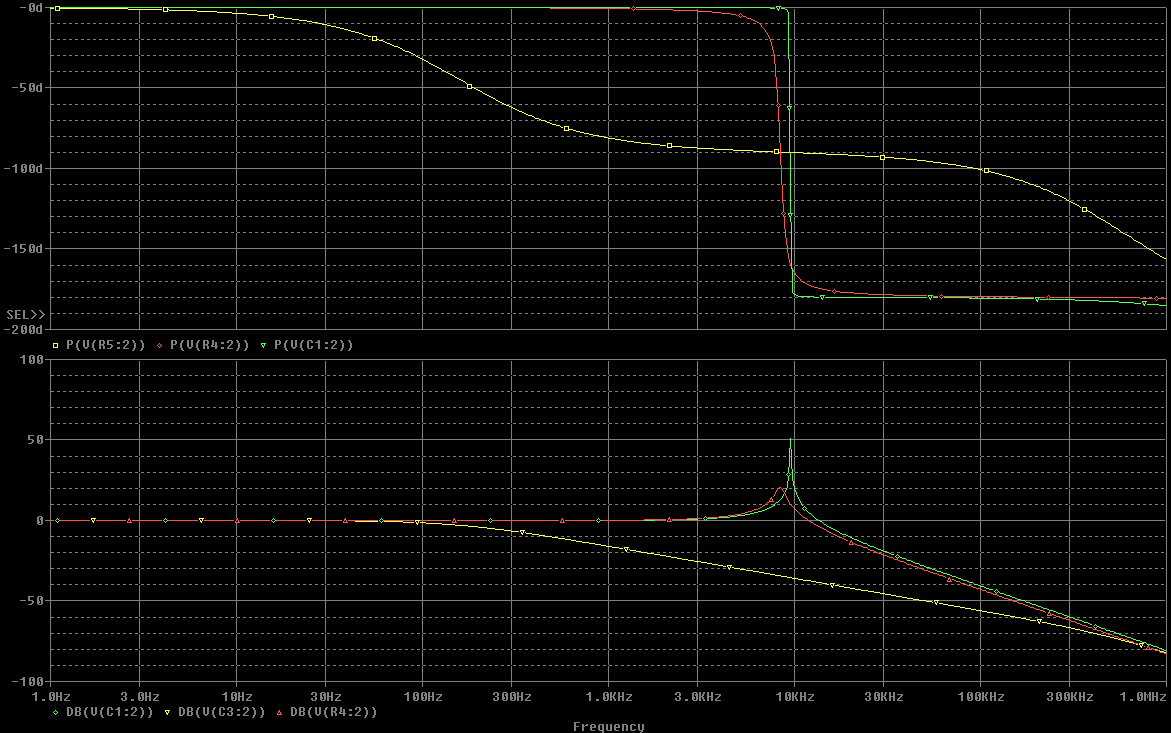

To view the stability behavior of the loop you can do an AC analysis to generate a gain and phase plot with frequency. My simulations of that showed a pronounced peak in the gain near the observed ringing frequency. From that I tried some different feedback compensation approaches until I eliminated the peak, giving a flat response up to the rolloff point (shown in the Bode plot) with good phase shift margin. This is the circuit shown in my post #6.
It's difficult to determine what's happening in a feedback loop without doing gain-phase (Bode) plots. Here's a primer on that.
Reactions: jasonc2 and FvM
    FvM
    jasonc2
Oh neat. Here is phase (top) and frequency (bottom) response for the three circuits I posted above (green is original, red is with diodes, yellow is with resistor):
That's pretty cool. So I guess, it's like a filter and it amplifies that frequency in the step input, and so I see oscillations at that frequency at the output?
I put a notch filter in at that frequency to see what would happen, but it just moved the oscillation to a different frequency.
I am now reading this document, it seems like a good intro: **broken link removed**
Why is it that the gain peak appears at the same frequency as the phase transition?
When the loop phase shift approaches 180 degrees, the feedback becomes positive, which causes peaking and oscillations, thus the phase transition and the peaking frequency are coincident.
Yes, the step input has high frequency harmonics, which excite the ringing frequency.
The notch filter introduces its own phase shifts which just causes the phase inversion and peaking to occur at a different frequency. The Bode plot will show that.
To eliminate the peaking you need a network that cancels the sharp phase shift change. The two capacitors and resistor added to the circuit in post #6 perform that function. If you simulate that circuit and vary the values of the capacitors, you will see how the peak changes value and moves in frequency.
Your referenced document looks like a good intro to feedback control systems.

Although the ringing behaviour can be guessed from the closed loop gain bode plot, the cause can be seen better in the open loop bode plot. Even more important, the open loop caracteristic allows to design effective contra-measures, as previously discussed.
Reactions: jasonc2
    jasonc2
Hi crutschow, sorry - but I am not "very happy" with your explanations. May I give my comments?
I suppose, jason speaks about the closed-loop phase transition - in contrast to crutschow who apparently refers to the open-loop response.
Thus, jason's question has nothing to do with loop phase shift 180 deg. The sharp phase transition and the gain peaking are closely related because there is ALWAYS a fixed relation between gain and phase (for minimum phase systems without RHP zeros) - also for less peaking and a more smooth phase response. This has been shown by BODE long time ago.
When a circuit suffers from a small phase margin there is no step input necessary to cause oscillations (decaying or not). That means: Not the "higher harmonics" excite the oscillations.
Each initial condition that is outside the equilibrium state will cause these oscillations - until the equilibrium state is reached.
By the way: It is also a common misconception that in oscillator circuits the noise will initiate oscillations.
This "sharp phase shift" is not the cause of the peaking effect. Instead, both effects are closely related and are caused by the loop gain which has a small phase margin.
Thus, improve the margin and the peaking will be eliminated.
