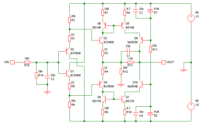

hi everybody,
i want to design an amplifier for amplify output of signal generator about 10vp
_p and output amppedance of 600 ohm, i want 100vp_p output with about 300kHz.
can anyone help me?
thank you,

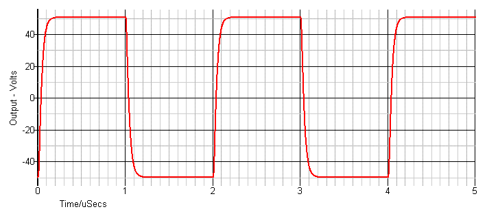

Maybe something like this? It's quite fast.....
The input impedance is 10K, so it will work fine with your signal generator.
The output impedance is about 100 Ohms. I don't know your requirements. What will the output of the amplifier be connected to?

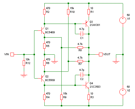

Here's a much simpler circuit that seems to work just as well.
I prefer this one. The other circuit was too complicated.

The circuit in post 5 is OK then. It can pass up to about +-50mA.
The circuit can be improved a bit though. Do you know something about electronics, so you can finish the design?

there is another problem,i used +-40v power supply and had good output but when used +-50v, R2,Q3 and Q4 are damaged. can you tell me why?
Most likely: Q3 or Q4 got too hot. They should be mounted on heatsinks.
Also possible: Q1 failed first and caused the others to fail. Did you use the right transistors, or others with a high voltage rating?
The amp is designed to work best with a supply of +-60V. +-50V is OK, but +-40V is too low. It will still work with +-40V, but the output will be distorted. If you want to use lower power supply voltages, then the design should be changed a bit.
