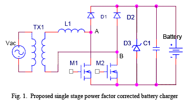

Hi all,
Here am attaching the datasheet of Batttery charger..Kindly go through it and explain me how they form boost circuit??and how they calculated the duty cycles?? If i would like to get 30V output to charge 24V,45AH battery how to calculate the duty cycle?? The mains waveform Has Positive and negative half cycles so how they calculated the Inductor value,duty cycle,charging current??they are saying that this circuit will form boost circuit in +ve and -Ve half cycle...In this circuit how to control the current?? I would like to have 7A charging current at initial.
One more thing,as we know the mains voltage has positive and negative pulses..so how to take instant voltages here to operate mosfets?? Since,here each mosfet will work in each cycle..

That is not a datasheet. The paper just describes an idea for a new kind of charger. Page 2 explains how it would work. You need to first understand how a normal boost converter works, then this one will not be difficult to understand.

I know that formula..Used in Boost converter when the input voltage is DC.. In DC the Vin(min) and Vin(max) are at certain voltages..so we can easy find the duty cycle.. But here,the input is 24VAC..Varies from 0to24V and 0to-24V..So how to vary the duty cycle here...Will i have to do this with sampling??
There are 2 switching transistors - one for each half of the wave, so each transistor only has to deal with 0 to +24V. The transformer secondary is floating, so there is never any negative voltage at A or B.
During one half cycle of the mains, point A is at zero volts and M2 is switching a positive voltage at point B.
During the other half cycle, point B is at zero volts and M1 is switching a positive voltage at point A.

Because they want PFC, they will need to control the duty cycle in such a way that the current drawn from the transformer is proportional to the voltage. They said that they would do that with a microcontroller, but I don't know the details.
The result, though, is that the battery is not charged with a constant current. If you want an average charging current of 5A, you will actually get a current varying sinusoidally between zero and 10A at 100Hz (or 120Hz depending on your mains frequency).

Your circuit has to monitor the current and adjust the duty cycle accordingly.
From the PDF:
The input current, input voltage and output voltage are measured and presented to a micro-controller, which provides a voltage control reference accordingly to the control chip L4981B from ST microelectronics. By this control strategy, the output current can be controlled by the micro-controller. Thus, customer desired charging profiles can be easily implemented with embedded software.

²Samson, I quickly looked at the article schematic and understand how it works. Let me explain, how I see it and hopefully that will make sense to you too.
The power supply consists of a step-down transformer with controls for PWM to vary the current pump charge that is programed to keep constant current and vary slowly as charge approaches 100% hence reflecting a 100% PF constant load.
The feedback consists of;
- primary current ( via CT1 )
- DC output to a comparator such that if below full charge then Vref is enabled and thus PWM output and I pump charge to battery. I suspect that threshold is 14.2V
- internal Vref is a classic ultra-stable bandgap diode @ 1.25V
- an active full-wave bridge (AFWB) which is activated at PWM rates and provides 2 of the 4 bridge legs and the other two with passive Schottky diodes.
- a filtered bridge called an RCD filter that is "before" the output stage of the AFWB hence,
- I call this latter signal a "DC potential" feedback which two signals;
- instantaneous FW rectified signal potential "A" and average DC voltage potential "C"
- the former, DC output actual, which also provides zero-crossing clock to sync. the PWM
- the latter average potential is simply a smooth or LPF'd full wave.
- the actual AFWB pumped output Voltage to the battery is also sensed / compared to enable or disable the Vref in original statement and becomes signal "B"
- lastly the PWM signal uses a multiplier / divider ratio analog circuit to define a signa, Current Regulator = AB/C²
- This control signal is compared with a triangle wave synchronized to the AFWB signal rectified DC out of "potential voltage" to yield a PWM sliced signal to correct the pulse width.
- These PWM signals being fairly high f (> 20KHz) are then synchronized with the incoming AC zero crossings to make a sync'd PWM.
I did not bother with the Math to caclulate values, but I understand how it works.
Any questions?
