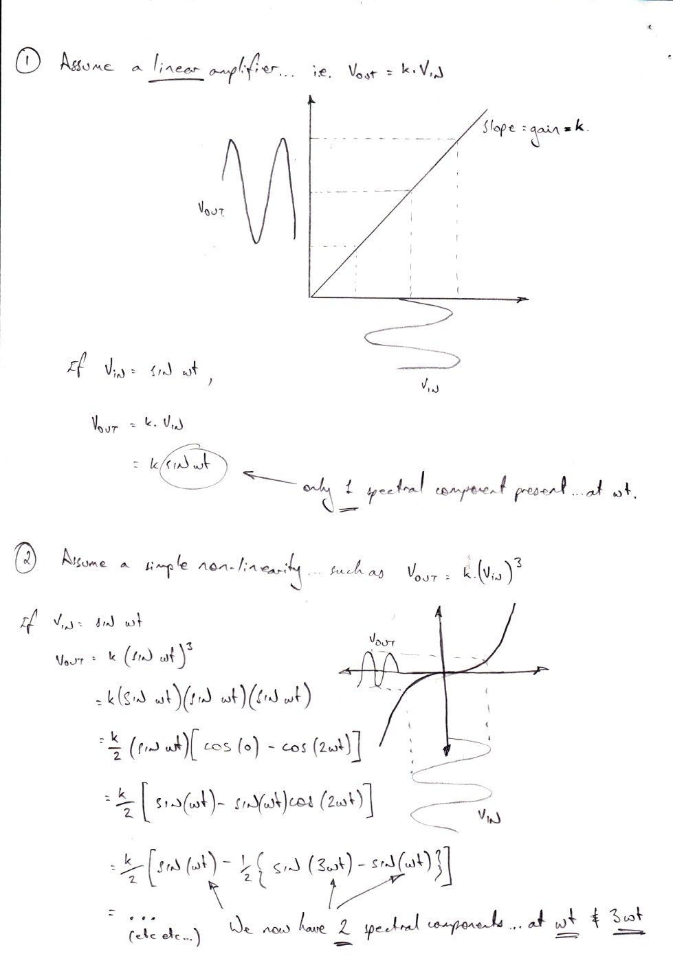

FvM's answer is the general (and "always useful") case - start with an arbitrary signal, and amplify it, subject it to a non-linear load etc. Whatever you do to it, record it (as a function of time). The Fourier transform of your recorded signal will reveal the presence (or absence) of harmonics generated by your non-linear process(es). To address how the non-linear processes produce the hamonics you have to peek at some math. There are numerous ways to do this - here's one (simple) example approach:
Here I've described 'amplification' of an input signal, although the same reasoning applies to voltages developed across nonlinear loads etc. In the case where your amplifier LINEARLY reproduces the input signal, the output is simply a scaled version of the input. We can illustrate frequency domain behaviour while skipping the Fourier decomposition process by assuming a single frequency sinusoidal input Vin = sin(w*t) ; where w = 'omega' = 2*pi*f - the frequency of our virtual sinusoid.
For the linear case, only one sinusoidal component is present in the output... namely the linearly scaled sinusoid that was present at the input. i.e. No harmonics.
Using a (contrived) nonlinear example Vout = k.(Vin)^3 ... [badly approximating a class B amplifier with HEAVY crossover distortion, for example] and applying a set of trigonometric identities, we can see that an output term at (3*w*t) arises - the third harmonic of our input sinusoid.
Needless to say such an example is a gross oversimplification, and real-world non-linearities are rarely represented with simple analytic functions, but it illustrates the point. Substitute a better model of your non-linearity; i.e. Vout = f(Vin) and a large amount of algebraic manipulation later you will have the amplitudes and relative phases of your harmonic terms.
