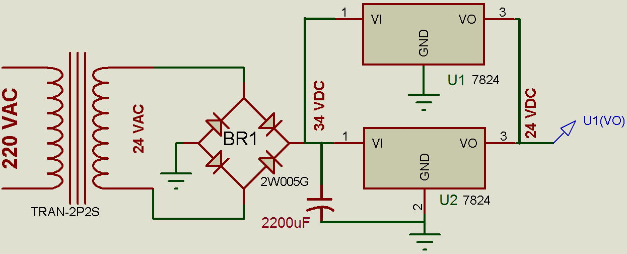

hi all
I have build the shown circuit, The problem is the 7824 voltage regulator is suffering from high temp, and I am afraid this high temperature damage the regulator,
how can I overcome this??
according to the datasheet the Max. input voltage is 40 Vdc. the device is supposed to work 24/24, the max. current is about 800mA
Thanks and best regards

Try using a heatsink, you need to calculate the thermal resistance, see some example
Ta - Ambient temperature (example 30°C)
Th - Heatsink temperature (example 50°C)
Vh - Voltage to heater 16V
Ih - Current to heater 0.8A
Tr = Temperature rise =Th - Ta = 50 - 30 = 20°C
Ph - Power applied to heatsink = Vh * Ih = 16 * 0.8 = 12.8W
Rth - Thermal resistance (in °C/W) = Tr / Ph = 20 / 12.8 = 1.57 °C/W

Here are the results I got:
@210Vac and 800mA load
C=1680uF to ensure 26V at the regulator input
Pdis of LM7824 = 3.3 W
@220Vac and 800mA load
Pdis of LM7824 = 4.5 W
@240Vac and 800mA load
Pdis of LM7824 = 6.9 W
Maximum Operating Temperature = 125 deg
Junction-Case Thermal Resistance = 5 deg/W
Estimated max air temperature = 65 deg
Required Junction-Air Thermal Resistance < (125-65) / 6.9 = 8.7 deg/W
Heatsink Thermal Resistance < (8.7 – 5) = 3.7 deg/W

The reason why it's getting hot is because it is a linear regulator. With 34v input and 24v output (load current = 0.8A), the remaining power (10v * 0.8A = 8W) is dissipated by the regulator as heat. That's a lot of heat dissipated. You need to use a good heatsink as has been said above. Alternately you could use a switching regulator which will be much more efficient and will not get so hot. Take a look at LM2575 and L4971.
Is this solution solve the problem?.
The current will divided between the two regulators.
i.e. the heat will be divided too.
and that will reduce the size of the heat sink
what are your opinions guys?
In theory, it works but how good the current balance between the two regulators couldn't be known for sure. In other words, one regulator might source more current than the other if there is a small difference between their regulated output voltage. And this balance may also differ with temperature. So one cannot be sure that the two regulator will dissipate equal powers. For instance I think you cannot split your load into two halves.
If it is just for one circuit you can test several regulators and choose the best pair. In any case it is good to mount them on the same heatsink.
As mister_rf has already pointed it out, adding equal resistors in series (one at each regulator output) helps in the current balance. Obvioulsy a higher value gives better sharing but the voltage drop also increases hence the output voltage will depend more on the load current. So a tradeoff should be made.
No, the regulators will not work properly in parallel because the will not share the load equally. An even simpler way to parallel multiple voltage regulators together is to add very low below 0.1- 0.2 Ohm ballast/equalising resistors in series with the regulator outputs. Doing so should make the regulators share current equally and therefore operate together without problems. However that this approach to load balancing makes regulation a bit less accurate
I think the solution now is to use a suitable heat sink.
and next time I have to use a switched mode power supply instead of ordinary linear regulators.
