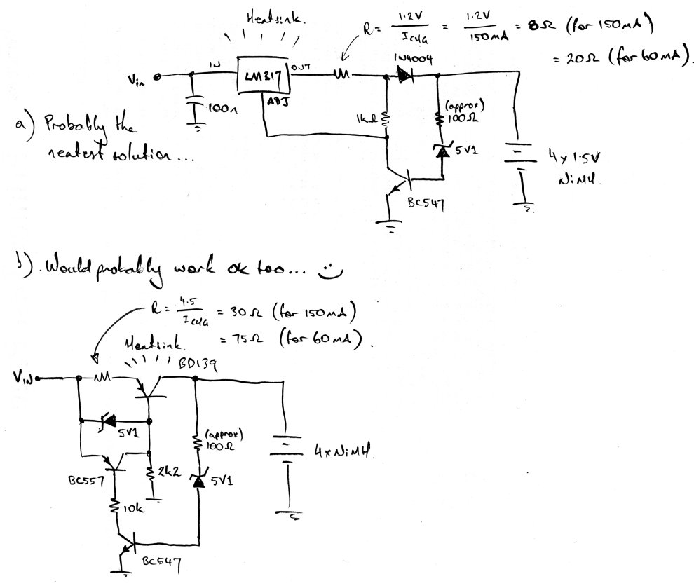

Hi all,
I need NiMh battery charger, with constant current, without MAx... and such IC, just make by transistor.
I need 150mA and 60mA optional charging current. Charger should stop at desired voltage level for 4xAA or 4xAAA 5,8V-6V
Heya nmbg011,
I just sketched a couple of simple options that might help you out... the first circuit would be my preference because the LM317 is inherently rugged and lends itself to easy heatsinking and can cope with a wide range of input voltages. Option b) adheres to your "strictly transistor" goal better though - your choice :)
I won't go into the detail of their (intended) operation here as you'll see the charge 'cutoff' configuration consisting of the zener/resistor/BC547 is common to both approaches, and I have previously described its operation in this thread: https://www.edaboard.com/threads/237775/. The remaining components form a conventional linear current source to supply the requisite charging current. This current is configured to reduce upon conduction of the BC547 transistor.
Hope that helps - let me know how it goes or if you get stuck!
P.S. Ooops! Just noticed that I wrote 'BD139' on the scanned sketch. I meant to write the part number of its complement - the BD140. (i.e. yes, it's meant to be PNP!)

@ThyLacine75 I try a.) circuit but no current and voltage termination. I try 82R 100R 120R on zener 5,1 and bc547 base.
I try different BC546 and BC547 and tha same.
I will try to replace zener.
I replace zener and now get termination of charging but charging is terminated completely, when I disconect zener charging go. I discharge battery to 4V and charging dont start. Old zener was probably damaged.
Resistor of zener is 100R, also tryed 47R, 82R, 120R and 300R, but charging dont start. Also I tried to put zener 3,3V but the same no charging, and when disconnect zener charging starts. :| Also tried to put higher resistors on zener 1K, 2,7K, 3,8K 4,7K and the same charging dont starts, when remove zener or resistor, charging starts.:-?
I will try to put some higher zener value then 5,1V (with resistor 100R):
Tried 5,6V without success.
Tried 8,2V charging is started, but voltage is too high for 4 NiMh.
Tried 6V zener and charging started, but with no full current.
Full current is set at 350mA (for testing) and with zener 6 current starts from max 90mA and goes down to 60mA@5,35V 40mA@5,42V 10mA@5,50V 0mA@5,55-5,6V
How this happen? :|:-?:?:
Hmmm - what a turd... nice job characterising the circuit's behaviour though nmbg!
From the measurements you've made, it sounds you're being plagued by zener leakage currents (which is further compounded by having a good, high gain BC547).
All (practical) diodes allow some reverse current to flow at reverse bias less than the breakdown voltage, at which point it increases rapidly. From what you've described, it would appear that your BC547 is being turned on sufficiently from the reverse leakage current to sink enough current through its collector and shut the LM317 down. As the zener breakdown voltage is increased the leakage current will be reduced (for a given reverse bias), which is why I'd figure the circuit struggled into life with zeners > 6.0V.
This gives us two options:
1. Reduce the effect of leakage currents, or
2. Decrease the rate at which the LM317 is shut down via the BC547.
The first option is probably the best, and one approach would be: Add a 470R resistor between the transistor's base and ground (the emitter). This means the transistor won't turn on until ~1.3 mA of zener current (well above typical leakage currents) is flowing.
The only possible downside to this is that your batteries can discharge via this path if their voltage is above the zener voltage. If this is a problem, adding a series 1N4001 (or similar) diode between the charger an the batteries will fix things (and increase the charge termination voltage by ~0.6 V, which may necessitate a zener value change).
Let me know how that goes for you - apologies I'm not in a position to prototype it myself at the moment, but with detail like your previous post I'm sure we'll sort it out in short order!

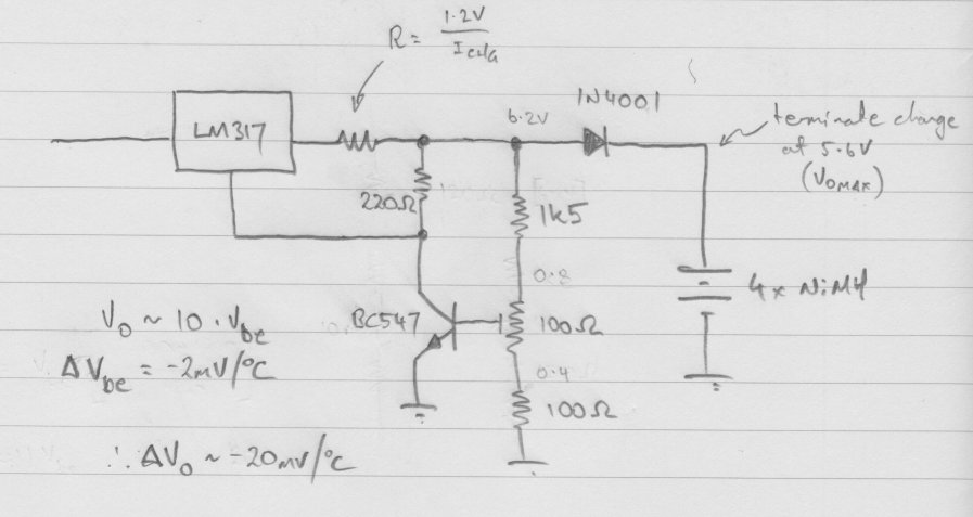

Rule 1 is why we added R4. By forcing the zener to develop a *voltage* across the resistor, we could more precisely define the turn-on of the transistor. Rather than relying on poorly defined (and tiny) zener currents, we could now count on ~600 mV having to be developed before anything would happen. R4 is relatively small, so this amounts to a macroscopic zener current. Much better! Once the transistor *began* to conduct, sure, a tiny base current is required to sustain the collector current, but this is only ~1uA, a factor of 1000 times smaller than the zener current required to develop the 600 mV across R4. Thus; a) we don't notice it, and b) who cares if it was 50x bigger or smaller? It's tiny! We have thus gained some independance from slight variations between zener diodes!
OK, back to the excessive charging current taper observed.
I suspect this will have a lot to do with the zener characteristics, and the parasitic resistance (mentioned previously) in particular. There's a couple of possible strategies around this:
a. Remove the parasitic resistance,
b. Insert a voltage reference and a high gain 'comparison' device to effect a narrow voltage decision threshold.
I must admit I'm a little underwhelmed (and I've learned a valuable lesson!) with the performance of the zeners we've seen here... so what if we got rid of it and relied solely on the transistor's Vbe as the voltage-cutoff-determining-value? Here's my thoughts:
I've added a 100R trimmer on the base to allow the threshold to be set, since the end-point is determined by the exact Vbe voltage that draws sufficient current from the LM317 to shut it down, multiplied by the voltage divider network by ~10x. Now, the effects of the transistor's temperature coefficient (which were/are present in the original circuit, just swamped by the zener's characteristics) are more clearly visible... enter BJT rule 3. The Vbe required to pass a given collector current DECREASES by 2mV for every degree (C) of temperature rise. Therefore the end-voltage will appear to decrease by ~20mV of ambient temperature increase. For charging batteries at room temperature, this is probably OK. Alas, it's also the best we can do with a single transistor (without temperature compensation networks).
If we added another transistor (or more), we could start down the road of approach b) - by constructing a differential amplifier to 'compare' a voltage reference (which could be a precision bandgap reference, or just a [comparatively well behaved] high voltage zener) with the output voltage and abruptly switching the LM317 on/off. While a fun exercise in BJT's (!), KerimF's approach is probably the better - grab an op-amp like the LM324 (which is especially nice since its common mode voltage ranges are well suited for single 12V supply operation). The LM324 is happy with a very wide range of rail voltages, so you could omit adding a regulated supply for simplicity. While you could add a series PNP switch (or FET) ahead of the LM317, I'd suggest retaining the current BC547 approach to shutting the LM317 down, since a series transistor has to pass the (higher) charge current (and dissipates [possibly negligible] additional heat to dispose of). Yes, the op-amp could certainly control either approach though :)
It's all a matter of how much complexity and what tradeoffs you're willing to make!

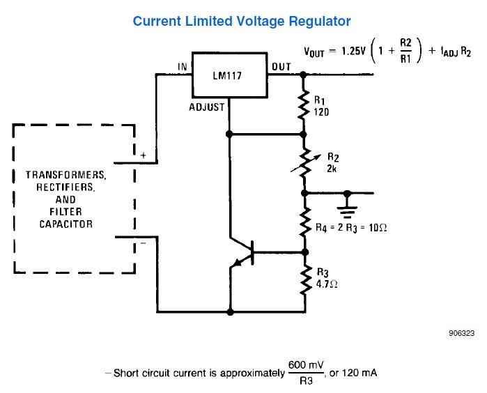

Apologies for the novel, but I'll leave you with a circuit that leaped at me that would probably also work for you nmbg and is yet another interesting permutation of transistor + LM317:
(Lifted straight from page 21 of the datasheet: https://www.ti.com/lit/ds/symlink/lm117.pdf)
The resistor values shown are pretty close to the currents you're after, and the voltage is set by appropriate choice of R2. The caveats to beware are: a) The input supply 'ground' is different from the battery 'ground', and R3/R4 will dissipate a few hundred mW (depending on your charge current).

Thylacine75 I try first solution from post #16 but no cut out, he stays about 5,90-5,93 with about current 70mA, with pot on max left, with pot max right he goes over 6V. I dont have pot 100R, but I use pot 300R with 150R parallel to get 100R pot.
I limit current from LM317 to max 100mA.
Also tryed 300R and 68R to get 55R pot, but the same, current is 80mA and increasing slowly, on other side pot goes to max limited current and higher voltage. He constantly increasing voltage, I turn pot on left side to decrease maximum voltage and put additional three diodes before batteries but voltage goes to 5,88V and steal increasing slowly at current 70mA. Three additional diodes plus one first from your original circuit diagram.
I will try to decrease 1,5K resistor to see result.
I put 1K resistor and current is 20mA at 5,66V, 20mA at 5,72V. I think that he floating at 5,70-5,72V at 20mA.
I will try now 560R resistor. With 560R current is low almost 0mA and voltage is on battery level, like no charging at all.
My first idea is to make easy to build NiMh charger with few parts on mini pcb, but maybe is better to do this with voltage comparator like LM741 or similar. How We can do that ? (Constant current charging and at 5,7-5,8V to cut off voltage and current).
