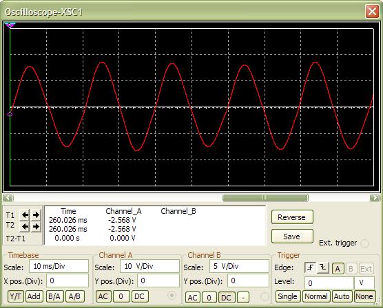

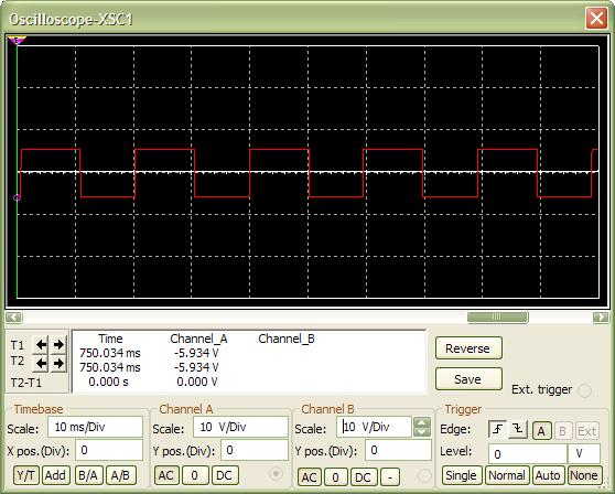

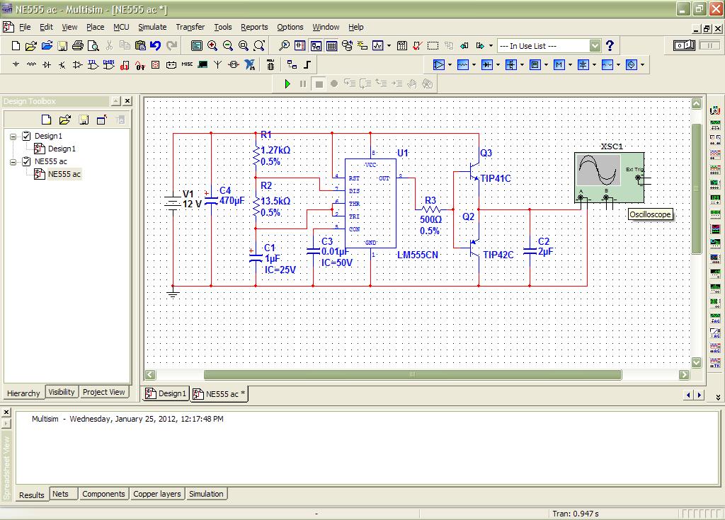

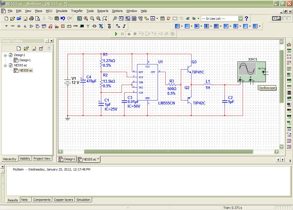

Hello everyone....
By your help and suggestions I had designed this circuit. It converts dc to ac (in both square and sine waves) and with the help of a transformer it can be boosted to 110 or 220 volts... Since I used TIP41C & TIP42C, so power dissipation is upto 65W.
Below is the schematic from the simulation and its resultant waveform....
For square wave=>
For sine wave=>
I hope it has no error.... If it has, then please rectify me....
