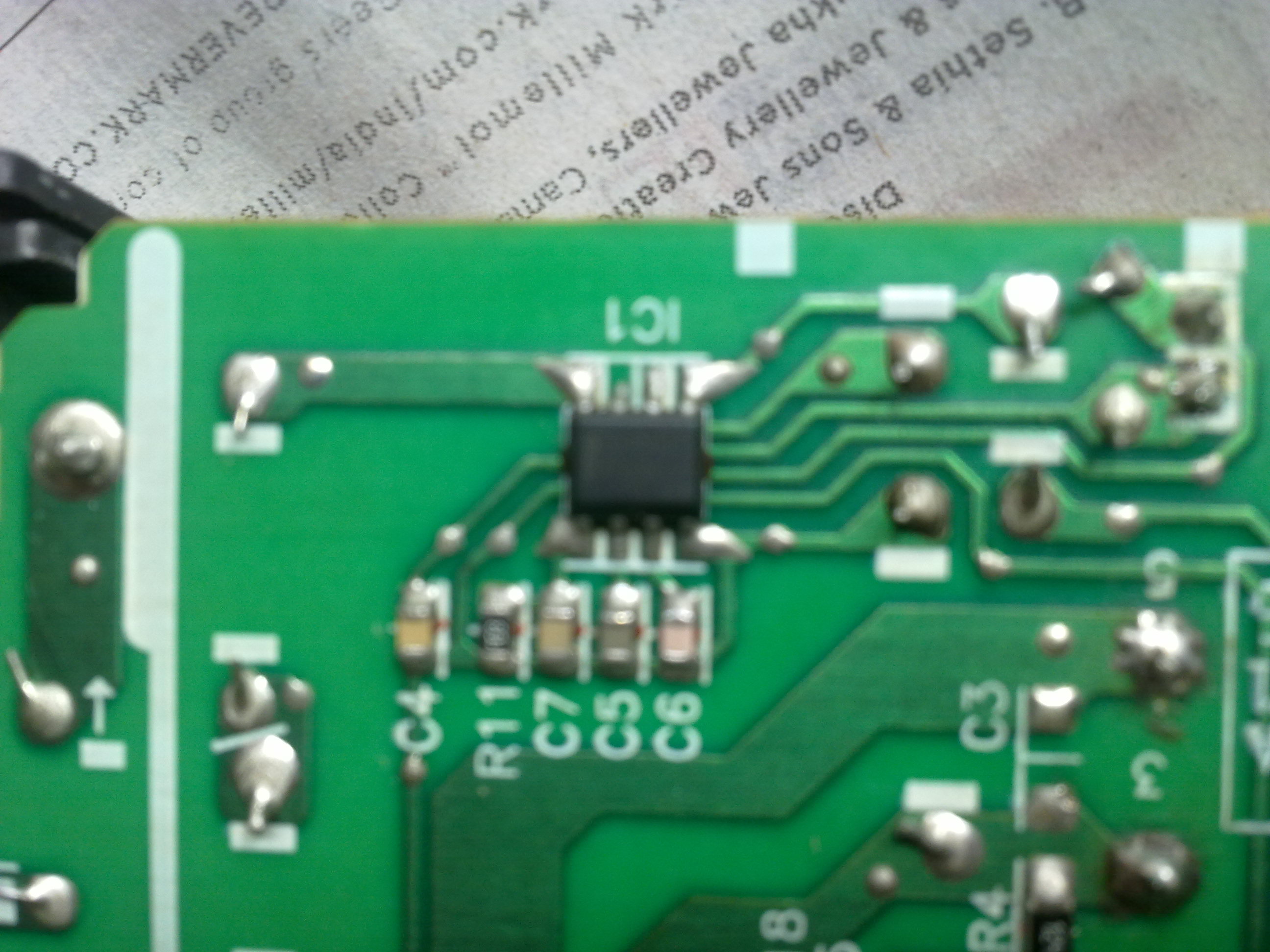

Yes, DAP8E is the marking.... I found it in a 24v 1.2A power adapter of a canon printer.... I m not sure what it works, that is why I want its datasheet..... But I can assume that this ic can be used for safety of the circuit...

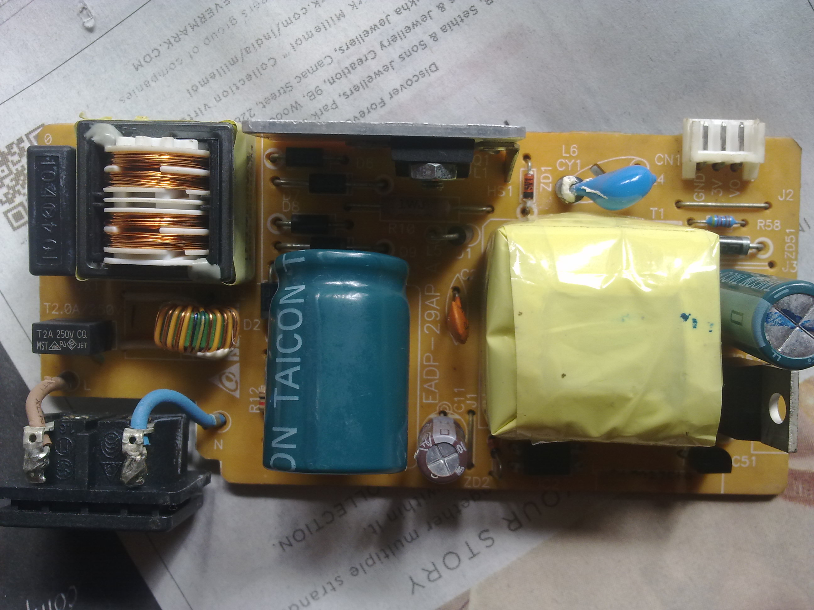

I cant take very close pic, but the following might help u......

In which case mr_rf is on the right path although that isn't the exact chip as the marking wouldn't be DAP8E. You need to look through some data sheets looking at the chip markings to find it - they aren't the same as the chip number as they don't have room for a full number.

I don't see any physical damage, there is a blown fuse? If the transistor tested okay then i guess you have to replace the capacitor.

Yes, I know the fuse is blown. But when it was in good condition, the voltage output of this circuit was only 6.5V.
I have checked the circuit thoroughly, but there was no physical damage seen. I would blame the ic and the transistor.
The 5th pin of that ic is connected with the gate of a Silicon N Channel MOS Switching Regulator(K3567).
The connection is something like this....
I can't understand which part to replace.....
And.... why that electrolytic capacitor have to be replaced???? It seems good physically...

Try to test using a multimeter:
D6-D9 diodes in the bridge rectifier,
power MOSFET.
Resistor R10.
If MOSFET shorted, possible R10 blown up and IC1 destroyed.
Later check all the components marked in red.
Change the capacitor C11 (low capacity).
