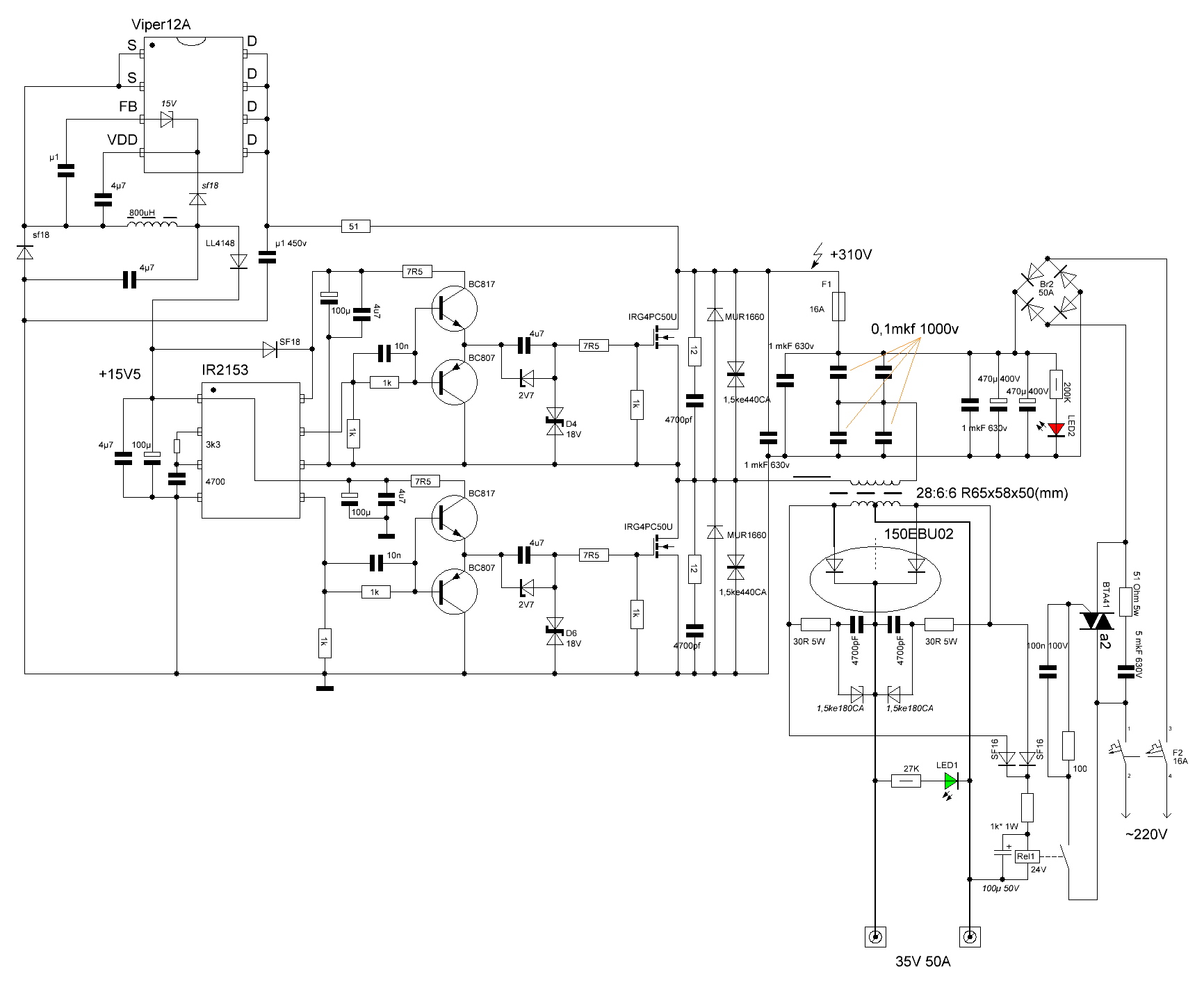

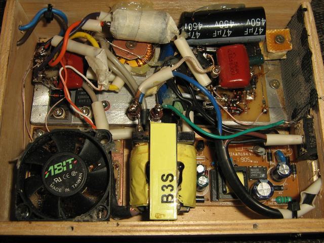

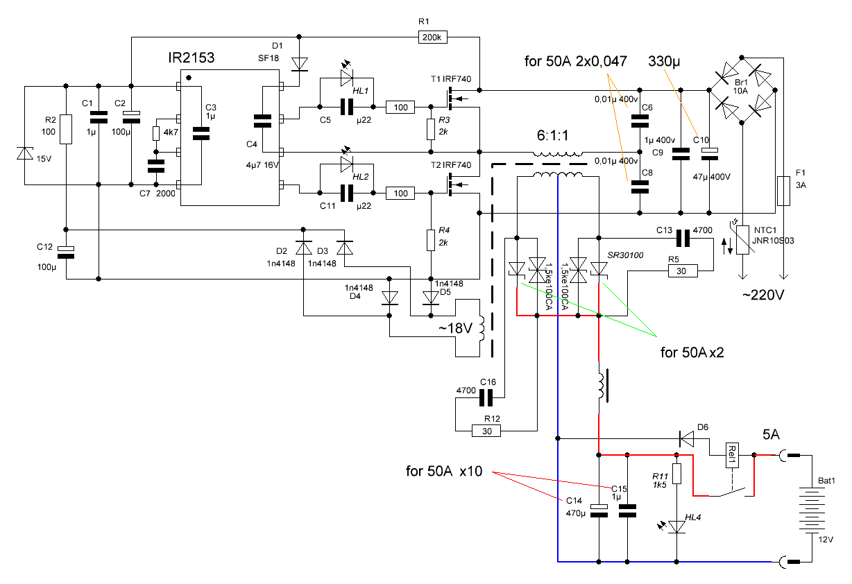

May be this scheme is useful. It is for 12V 55Ah car battery, but remake for 24V 50A not so complicated.
So which parts would you replace, seems like a big jump to me. I want it to charge a solar bank on cloudy days. I don't see how the voltage is determinded. I don't see any zener diodes. Does this shut off at full charge. I don't see that ether. the two diodes coming out of the transformer that are circled look like zeners but that dosen't make sense to me as it should be high speed high current. I can't cross the number that is listed. I would like some help. Thank You. Dan

Hi, all.
voltage determninded by battery, in general, because power of PSU is limited by the capacity of half-bridge capacitors;
You may see two as minimum );
yes, and mcu also provides protection from shorting of output wires and reversing batteries;

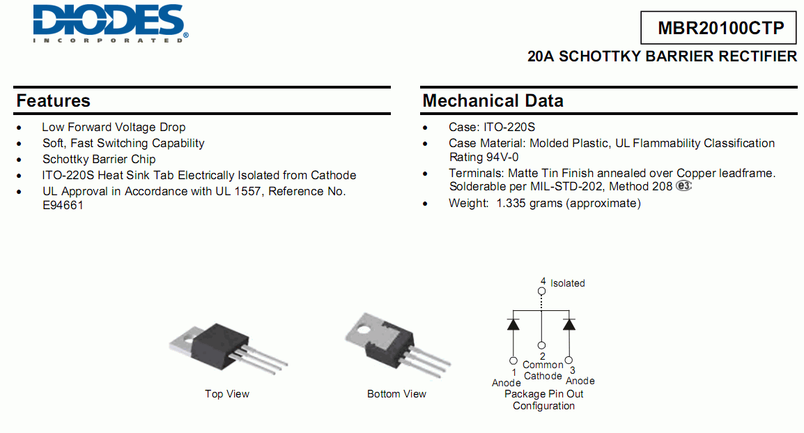

it is MBR20100, 2x 10A 100V schottky diode (taken from old PC PSU), of course possible use something another, such as SR30100;

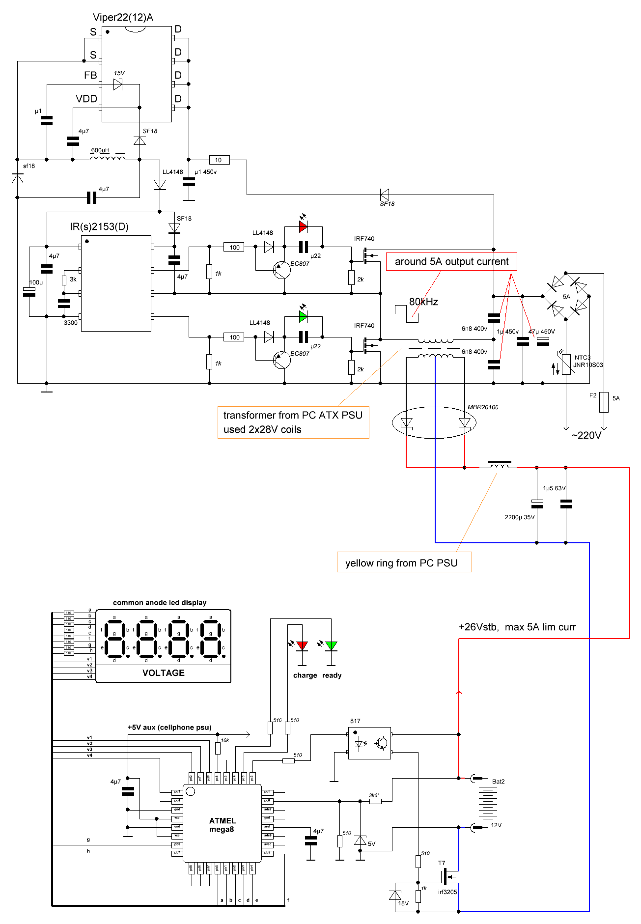

For charging 24V batteries possible use two such devices because 24V battery usually consists of two or more 12V units. However come to increase half-bridge capacitors before 68nF and capacitor in 310V chain before 330uF. Also be necessary to do more powerful transformer and output chains.
Or possible do one powerful block for charging whole 24V battery.
Like this -
And, of course, nothing do not disturb to do same on any pwm chip like tl494, sg3525, uc3825, etc., except that several greater difficulties.

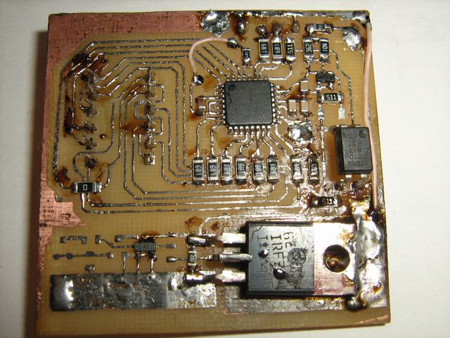

ok, so pcb picture for this

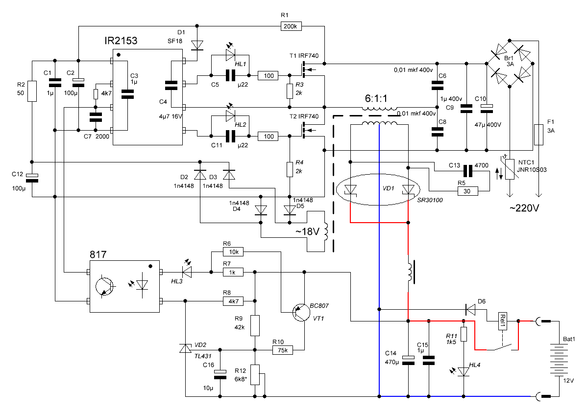

and better if R2 must be 100 Ohm, not 50.
And, also - for this scheme it is need only ir2153. Not irs2153, ir2153D, irs2153DS. But with Viper (or any other aux ps) possible to use any version of ir2153.
Schematic for device without self regulation and with manual on and off.
Suitable for transformer calculation -

I see only one zener, is that correct.
yes, but possible add else pair if anybody desire. )

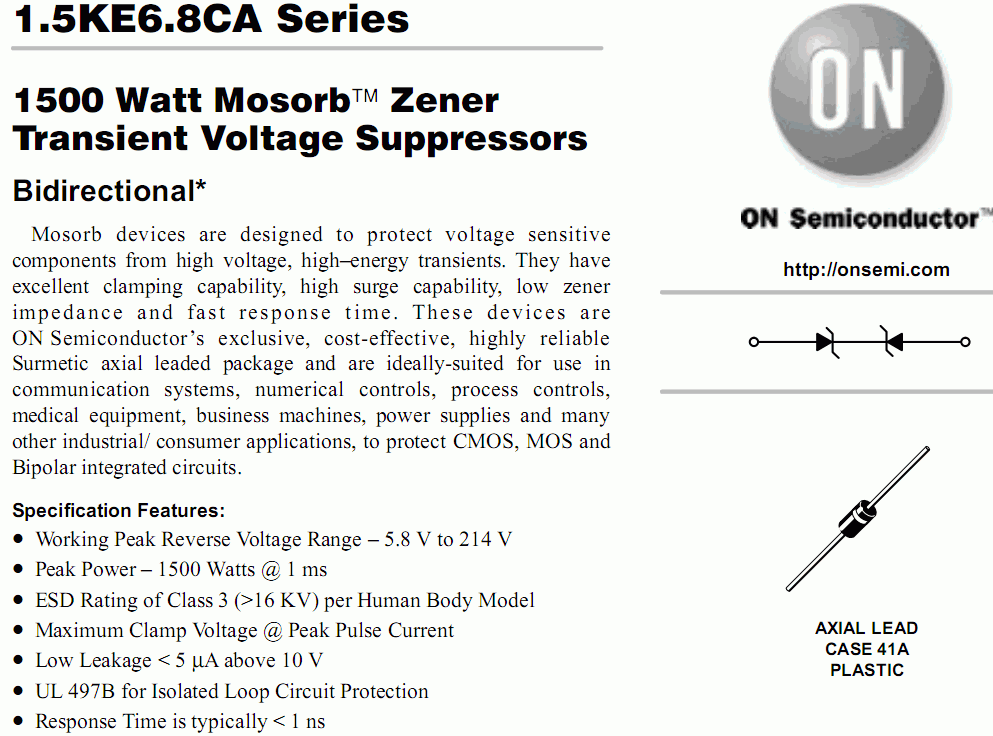

What is 1.5KE100ca.
it is supressors for protect rectifier diodes from surge spikes.
What is REL 1
For absence of mcu this relay protects scheme from reversed battery.
12v 5a. Is that an oversight.
no, changes required for obtaining 50А is specified in accordance with colour line. For сharging 24V battery it is necessary to take two such device or one more powerful with another scheme.
