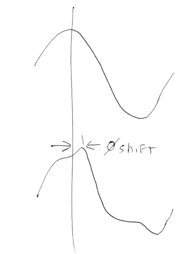

Hello, I've built a a 64MHz 4W class A PA for use in a MRI system, and I've recently discovered that its phase shift changes depending on the input and output power, by about 30 degrees over its full range. This is frustrating, because I need to vary amplitude and phase on the output with a good degree of accuracy. To be specific, I'm making short RF bursts which generally differ by 6dB in power, and must be 90 degrees out of phase. I have a feeling that this is a problem that linear amplifiers will always have to some degree. So I'm considering making a class D current fed amp, which would be amplitude modulated by its drain voltage. Would a switching amp have less phase variation than linear amps?

This is a very common problem in communications systems. It is called AM-to-PM conversion, and amplifiers are specified to minimize it.
I would suggest that you use a very stiff (low impedance) bias structure to keep any RF rectification to a minimum. A DC bias point change will cause a phase shift.
Another reason for a phase shift would be the generation of harmonics and/or clipping, which, when summed in the time domain, can look like phase shift. You might actually want to use a technique called "feed fortward" design, where a power amp supplies most of the output power, but a second parallel amp supplies the sine wave peaks. The combination of the two is a reconstructed pure sine wave, without the phase shifts you are experiencing.
I measured my phase shift by putting a tuned coil on the output of the amp and looking at the field from the coil with a pickup loop. The coil has a Q of about 150, so it filters off pretty much all harmonics, so I doubt this is the case.

Again, this may be my issue. But what is the actual mechanism here that causes poor AM-PM? And what impedance should be aiming for?

To get considerable phase modulation, as you reported, there must be some high Q circuit part that slightly changes it's resonance frequency depending on the signal level. When I hear about your test setup, I suspect, that the tuned coil added for test is the cause of phase modulation. If you don't have other high Q resonant circuits in the PA, it's the most likely explanation, I think. The resonance frequency shift can be e.g achieved by signal dependent output impedance variations.
As a first try, get rid of the additional filter.
This is a reasonable explanation, but without a high Q filter on the output I don't see how I could measure the phase of the fundamental signal accurately at high power levels. I have a nice VNA, which has a power sweep option on its menu, but I haven't been able to get it to work for some reason... that would be so useful for this...
Also I still want to get some mathematical understanding of how AM-PM occurs. The only source I could find with a quantitative analysis was this: **broken link removed**
It makes sense somewhat... the odd harmonics resulting from compression will result in a DC component on the output. If the amplitude is changing continuously, then the resulting DC does as well, causing the zero crossings of the output to change, and thus giving phase shift. However, this only applies to when the input signal is continuously changing amplitude. If the amplitude is changed, but then left constant for a while, and the DC component is filtered off, then the output should settle to the original phase shift, right?... so this really doesn't explain AM-PM conversion in the sense that different amplitudes have different phase shifts at steady state; just that rapidly modulating amplitude will cause apparent phase modulation. Does this sound right?

am-pm, uncompressed vs compressed output:
I assume you're saying that distortion makes it look like phase shift? Sure, that's why I was intending to do measurements with a filter on the output.
