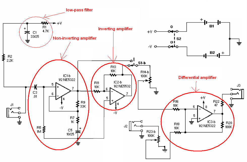

I don't know every time I open an electronics book I get very much afraid after looking at those circuits. As an example have a look here:
How do you keep track of such complicated and complex circuits when solving them at school? What is your advice for me to overcome this fear? Sometimes, I simply slip into depression after looking at those circuits in the book. Please advise me what to do. When you were at school how you kept the track and solved the circuit. With simple circuits like this one:

In each case you need to break things down in to bite sized chunks. In your second circuit you have a load resistor and two other resistors (25Ω). So, you combine those so you now have only one resistor to consider in place of three. Then you combine that with the next resistor (40Ω). Then you have just three resistors - two at 20Ω plus the new one you have calculated. You can even combine the two 20Ω ones. Don't try to look at it all at once.
The same applies to the larger circuit. Instead of trying to look at six opamps, follow the signal flow of one of the inputs from the jack J1. When you reach the switch, pick one position and ignore the other. When you have followed the signal through to find out what it does you can then consider the other switch position. Then you can look at the other signal path. It may not be quite obvious the way it is drawn, but the top half and bottom half are identical. If it was drawn better then that would be easier to see. Maybe draw yourself a block diagram to simplify it as you work out what each bit does.
So, analyse each bit at a time. Simplify things. Draw your own diagram. Scribble notes on the diagrams as you go.

I don't think I could have said it much better than Keith. This is the same approach I take when analyzing some large, complex circuit or system. One of my favorite says is this: "How do you eat an elephant?....... One bite at a time." So, like Keith mentioned, find an input to the circuit and start tracing it's path. When you reach a point where another signal ties in, work back to find it's source, then walk through the second signal's path. Start at one end and work across the circuit.
Most complex circuits can be broken down into functional blocks. There may be logic gates, op-amps set in any variety of modes (but more are recognizable... inverting amplifier, integrator, comparator, etc), transistors (generally used as linear signal amplifiers or as a simple on/off current switch), etc. So, find a circuit element (and it's nearby parts) that looks familiar, and try to fit the circuit to something you've seen before. Once you have an idea what that block does, look at the circuit that it drives, and figure out what it does, and so on.
Heck, if the big circuit freaks you out, cover half of it up with a sheet of paper and pick through the uncovered side!

Looking at this circuit, MY mind does the following:
1) look at the types of connectors. The connector symbol, and the fact that it has two hot and one ground lead on both input and output tell me: STEREO AUDIO APPLICATION
2) The part number on the op amps tells me it is probably an old schematic, so nothing complicated about its function: PROBABLY A PREAMP OR AN EQUALIZER
3) I then look at the two switches. One is power supply, the other is a ganged DPDT. The circuit is symmetrical, and two of the switch inputs come from inverting op amps, the other two from non inverting op amps. Conclusion: IN-PHASE/OUT-OF-PHASE SWITCH
4) There are no additional switches or potentiometers, so there would be no way to adjust the gain or the frequency response. Conclusion: IT IS NOT AN EQUALIZER
So you put it all together and conclude that it is a: FIXED GAIN STEREO PREAMP WITH 0/180 DEGREE PHASING SWITCH

Your opamp circuit has two identical channels. So you can analysis only one channel. And you can brake the circuit into the functional blocks quite easily.

Jony has the right idea, regarding a functional block breakdown of the circuit.
From a high-level view, a function block is just what it sounds like.... a "black box" that takes some inputs, and generates some know outputs, based on the inputs. Think back to your grade school math class, when you first learned about math functions. A function f(x), takes a variable, x, manipulates it, and returns that value. Example:
If f(x) = 2x+3,
Evaluate the following.... f(x)^2 - 5*f(x), when x=3
How do you go about solving it? You plug 3 in for x, evaluate the FUNCTIONAL BLOCK of math that is f(x), then stick it's output into the top-level equation, and finish evaluating. Like so:
f(3)=2*3+3... so f(3)=9, then
9^2 - 5*9 = 81 - 45 = 36
The same can be done for any complex system, from hydraulics, to biological process, to chemical reaction, nuclear power plant cooling systems, and even electronic circuits. So, like Jony showed, find a part of the circuit that looks like a common, well-known circuit and make a perimeter around it. Some signals come it, that well-known circuit performs a known task (amplifier, filter, inverter, etc), and supplies some defined output to the next item in the system. Once you've seen some of the standard circuits a few times, they will become easier and easier to identify.
It takes time to deconstruct complex circuits, so take your time, and pick through them one bit at a time. Look for circuits that you know, and then grow out and follow the signal flow from there. It takes practice, but sooner than you realize, you'll be ripping into complex circuits without any fear or hesitation.
When all else fails, you can always fire up PSPICE (or your favorite circuit simulator), build up a small part of the circuit, run some signals into it, and see what comes out the other side.
