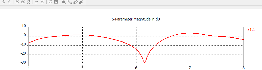

Hello all,
actually i am facing the same problem but with CST,the both side of S11 more than 0dB.
Is there anybody could help me please about this matter ?
i attached an image show the problem.
Appreciated
Oh flip, all I needed to do was to choose active S and then dB10/dB20normalize.
While I haven't done that before, it doesn't seem like that would solve your problem - it would give realistic values, but it seems like the values would still be warped due to the error introduced.
I've found that such behavior generally occurs for port heights of approximately lambda/2.
hi PlanarMetamaterials ,
thanks for ur help, actually i changed the dimensions of the port and i reduced it's height, but S11 became like in the pic below!!
i think it's much better but still there are frequencies have a positive value,
wt's ur suggestions??
regards
the port size is 6 times as wide as the width of the microstrip line(1.9) and 5 times as high as height of the substrate(0.813),but when i use this height i got positive S11 in both side,and when i change it i get different result like the one i sent it to u before .
Have you looked at the mode it's producing? Maybe something strange is going on there. Also, maybe try defining the integration line manually.
You can try to improve the mesh or a larger frequency range.
hello all,
thanks for ur reply,
PlanarMetamaterials please,how can i define the integration line manually?
flanello i tried several times to change the frequency range and make it larger but it gives me error on the simulation((the calculation seems to be unstable!))
