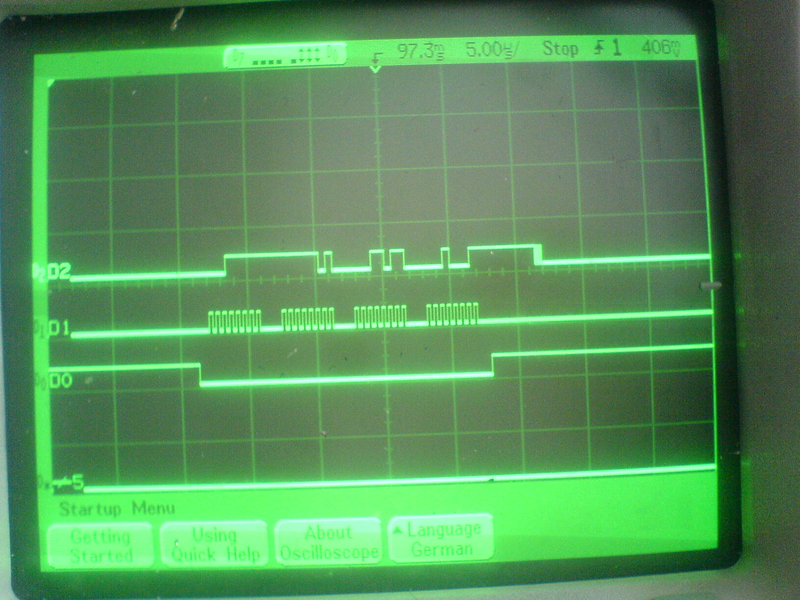

LTC2440 Problem: SDO Output Always Logic High
salihonur
Newbie level 5
Newbie level 5
Jul 13, 2011
9
1,383
I have a strange problem about LTC2440. Proteus simulation runs perfect, but the SDO pin of ltc2440 gives always logic high at real circuit. I watch the waveform on the scope and see same as this (Note: I draw short form of the wave 4 clock pulses instead of 8 bit).
SDO ___-------------------------------------------------____
SCK _____-_-_-_-___-_-_-_-___-_-_-_-___-_-_-_-__________ (actually 8 pulses in each clock group)
CS --________________________________________----------
I think the problem is about physical. I have added the schematic and source code. How can I fix this problem?

Maybe because setting Serial Data Input= ''1''? :cool:
This pin is used to select he speed/resolution of the converter. If SDI is grounded (pin compatible with LTC2410) the device outputs data at 880Hz with 21 bits effective resolution. By tying SDI HIGH, the converter enters the ultralow noise mode (200nVRMS) with simultaneous 50/60Hz rejection at 6.9Hz output rate.
http://cds.linear.com/docs/Datasheet/2440fd.pdf
No change. But sometimes it give different values rondomly. I wonder if the problem is caused by PIC frequency. May it possible?
I had connected SDI pin to PIC and same problem was happened.
I tied SDI pin to GND and i read the values every 20 loop period. However data is like rondom. What can i do more?
The frequency of SCK is 2 MHz.
The problem is shown in the picture. All things are on same position. But adc sends data like randomly.

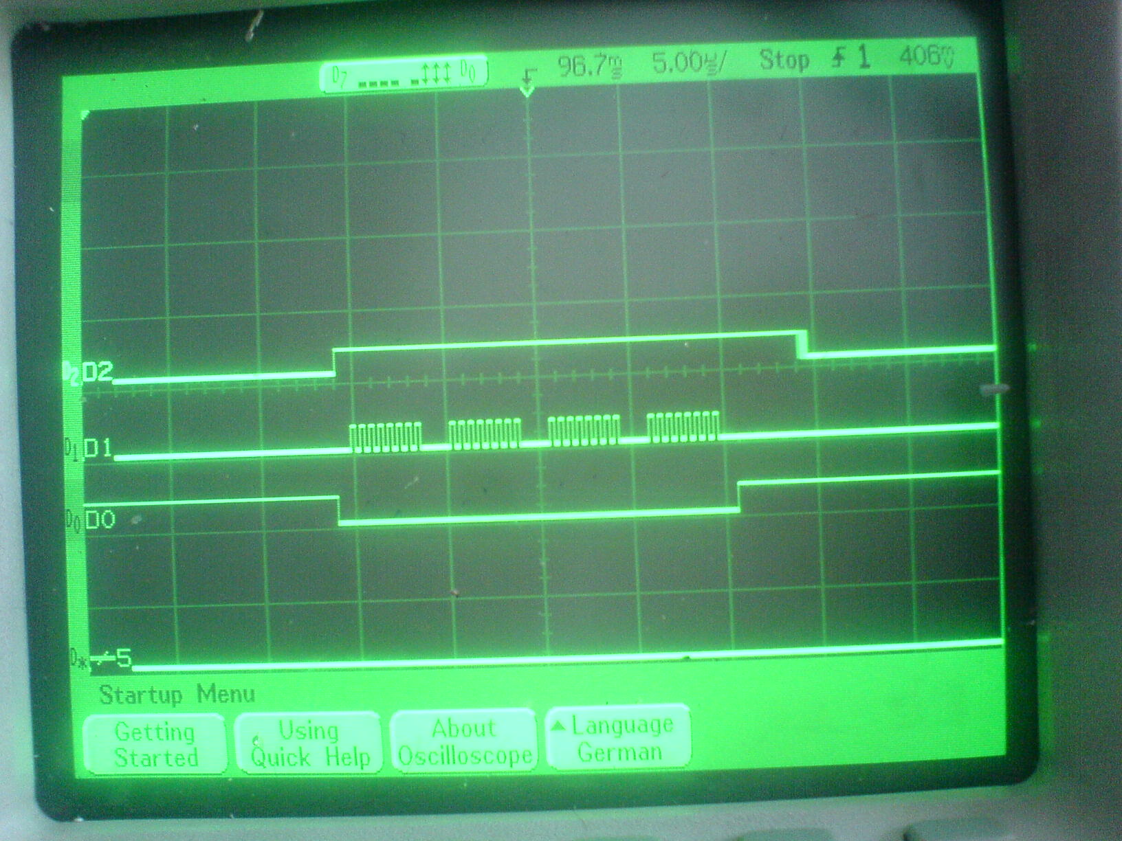

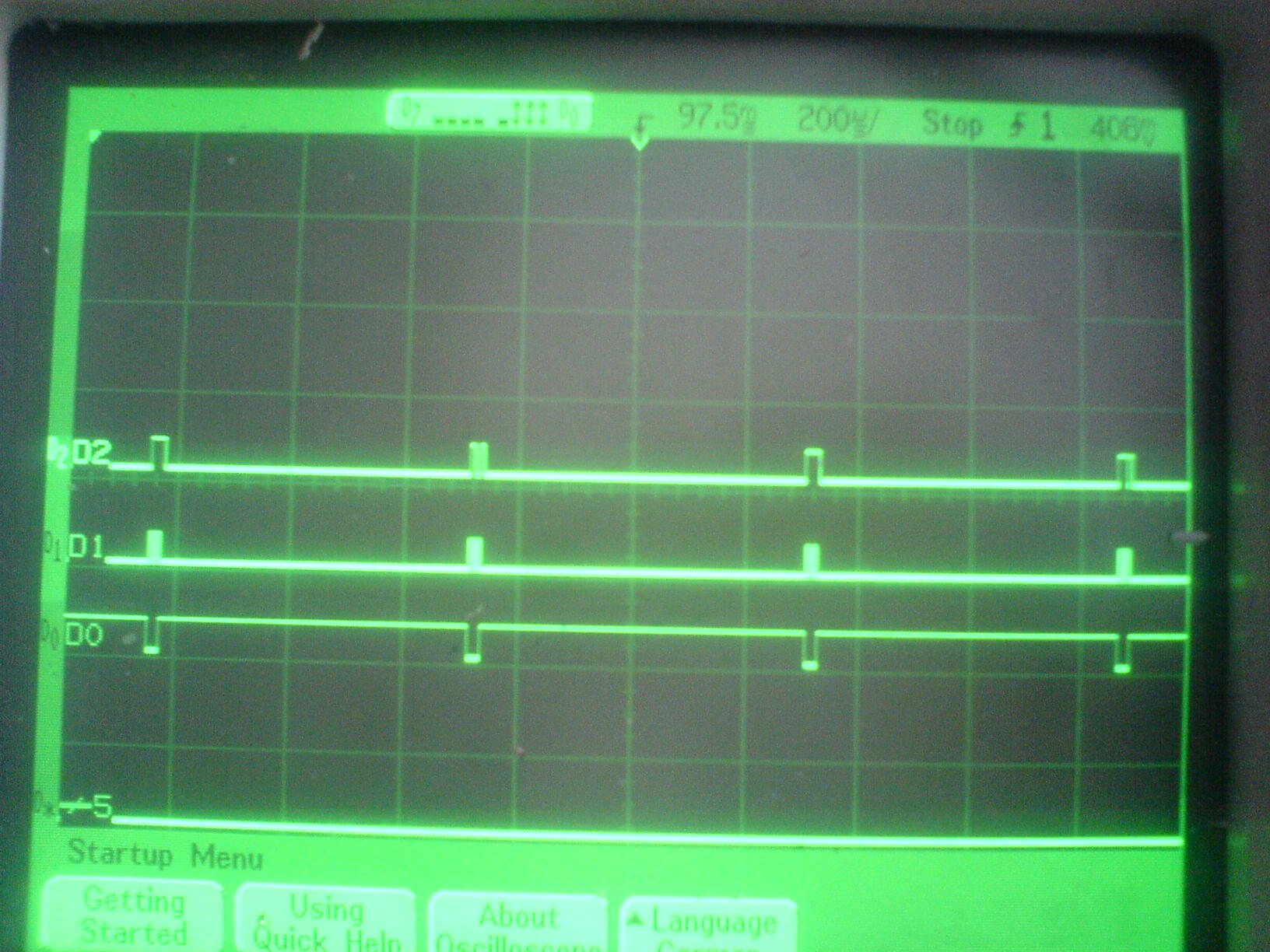

Hi again. I have changed the circuit and the software in accordance with the product datasheet. EOC is checked every 32 bit spi reading if conversion is active. The BUSY interrupt gets logic high after the last SCK clock. (External SCK and single conversion, 3 wire SPI)
All pictures show the same reading action (both Vin- and Vin+ pins are connected to GND). SDO output waveform are still different. And EOC=0 in all reading action as well.
I'm still in trouble :(
Preferences like this:
OSC Frequency = 32 MHz
Timer 2 = 508.13 Hz setup_timer_2(T2_DIV_BY_16,82,12); // timer is 508.13 Hz
SCK is generated by timer2 setup_spi(SPI_MASTER|SPI_L_TO_H|SPI_CLK_T2|SPI_SS_DISABLED);
SDI is connected to GND, so conversion rate is 880 hz. Do I have to set the timer2 for 880 hz or above (for ex. 886 hz)?
