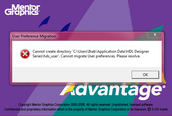

hey all,
can anyone help me if i can work on my win7 OS,a versin 7.2 of mentor graphics (FPGA advantage)
best regards...ty all
upload an image of the error that appears to you
Helo ihadser
to resolve this problem open the command window (cmd.exe).
verify that the promt get you dto drive C
type the following with the quot. marks:
md "c:\users\Ihab\Application Data\HDL Designer Series\hds_user"
verify that the directory was created by typing:
cd "c:\users\Ihab\Application Data\HDL Designer Series\hds_user"
if the prompt is the desired directory close the command window and run FPGA Advantage again.
I assume that it will require new dirs for that repeate rhe process.

This works for me! Thank you very much :)
