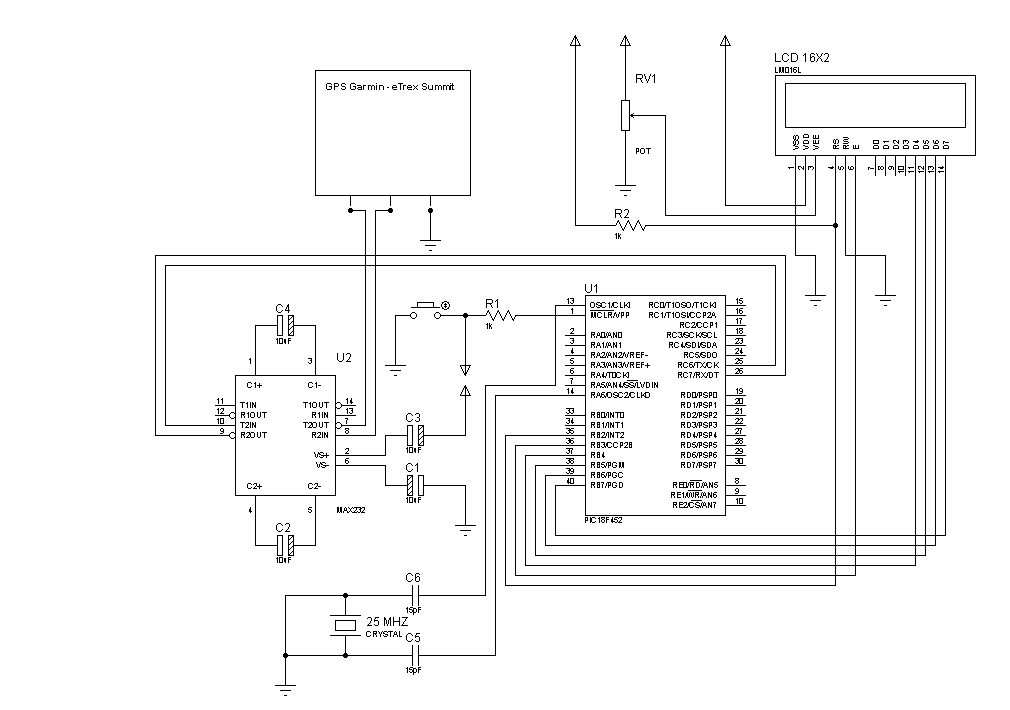

i'm student tring to develop an aplication that gets the nmea code $gpgga from gps garmin and send thought gprs SIMM900.
but my first step is get the code...
i did and send to pc thought max 232 to pc... fine works beautiful... but when i send it thought pic to display in the lcd, some caracteres are not fine, are grab... i dont know why is that.
some one can help me?

what help you expect here now???? who can understand your problem without circuit and code.... you did not tell how many characters you are getting properly. increase the array length used to store the incoming data.
are you printing data on LCD in ISR ?????
learn to post the requirement properly.....

hi this is the code just for the first step, whitch is to get de gps and disply in the lcd.
char i;
unsigned short j;
char strGPS[16];
void main (){
Usart_Init(4800);
do{
LCD_init(&portB); //Init sinaliza a configuração 'default' (D7,D6,D5,D4,E,RS)
delay_ms(1000);
Lcd_Cmd(LCD_CLEAR);
Lcd_Cmd(Lcd_Cursor_Off);
if (Usart_Data_Ready())
for (j = 0; j < 15; j++)
i = Usart_Read();
Lcd_Out(1,2,i);
strGPS[j]=i;
Lcd_Out(2,1,strGPS);
Lcd_Cmd(Lcd_Clear);
}while(1);

i'm organizing the circuit to post.
hi, ckshivaram
my circuit...
and here goes an youtube video that show exactly what i want.
YouTube - GPS GT-320 + PIC 16f877A - By Marlon
but my pic is 18f452.
thanks!

i think there is a problem in the usart_read;
yes.
but the code i've send to you just take what came from gps and show on the lcd.
this part i still dont know why it's wrong because the caracteres are not ok, it's showing some garbage, not the proper caracteres.
some times????? could you clarify more on it. when you get junk and when you get correct.. what is the probability of getting correct data out of ten trials.........
I was thinking it was casual, but no.
some characters appear, I thought were valid, but all are garbage.

it takes part of the string and send to the computer... yesterday i did!
i did not used your program, but i understand what you did (some part of it)
my problem now is the lcd... i remove the part of the code that initialize the lcd, and did some testes using usart_write to send messages to the PC, now its ok, but without the lcd...
the line "LCD_init(&portB);" have some problem... not the program, but i think is some problem with the ports of the pic
i'm using 18f452.
ckshivaram,
i finaly make the lat, long, and date show on the lcd...
