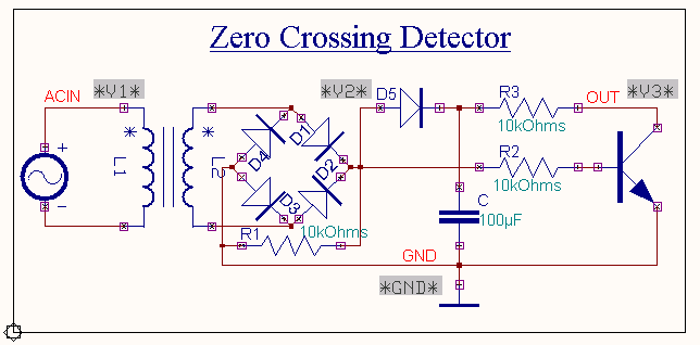

The whole thing is the zero-crossing detector. It works like this:
The AC voltage is changing value and direction and is converted to DC. Whenever the value gets lower than 1.4v, ie, it starts approaching the zero crossing point, the LED turns off, while, at all other times, the LED is on. Since the LED turns off, there is a +5v present at the signal pin. At all other times, the output is 0 as the LED is on and so the transistors pulls it to ground.
In the 2nd diagram, I used the TLP620 which is a special optocoupler containing 2 anti-parallel LEDs, thus requiring no bridge rectifier. Here also the operation is similar.
So around the zero crossing point, there is a +5v signal that the microcontroller must detect, maybe using an interrupt or even using polling.

hi,
Just see the attached image i want to chech the zero crossing ciruitry before desining with Capsense IC.
I work with this circuitry using Microcontroller 89c52.
But it is not working please help me out

i need to check the zero crossing detector circuit.
But i dont have the oscilloscope
I tried to connect the LED at the output of collector of theTransistor and connected the zero crossing ciruit to microcontroller 89c52 .as per the attached circuitry
But the Led is not glowing .i have used BC547 transistor what will be the output of Transistor 5v /0v
How did you connected the led?
The Anode of the led should be connected to +ve through a current limiting resistor (typically 330E for 5V). The cathode should be connected to the collector of the transistor.
Even though the led will be blinking at the rate of 100Hz.
please explain how this circuit work what will be output at collector
