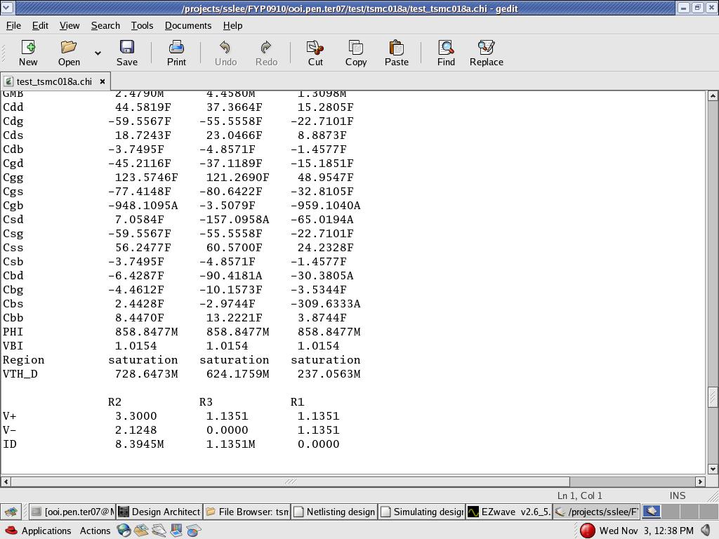

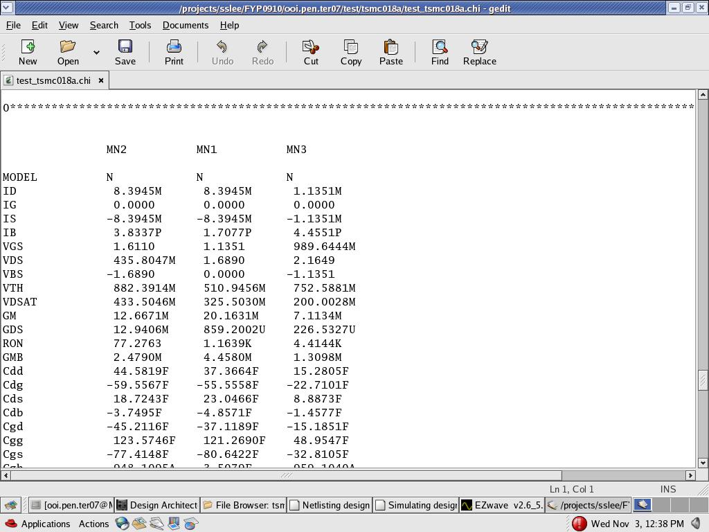

I am currently designing shunt feedback transimpedance with cascode gain stage and source follower.

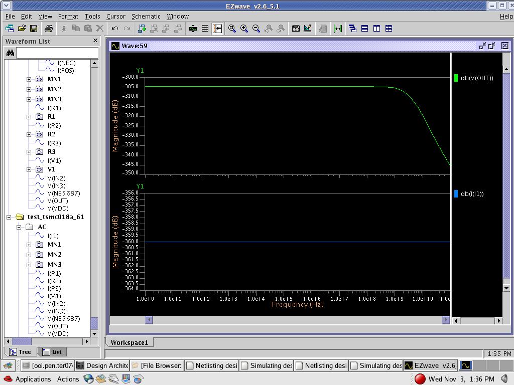

I am able to get the gain at 525.6 for Rf=1k
but when I simulating Ac analysis with magnitude 1A , my Vout went to large negative value .and my biasing is correct.I can't find any solution to it.I also duno why it happen.Can someone guide me ?
These two are the info regarding the transistors
Transimpedance gain
Ac analysis circuit
bandwidth
Break your feedback loop!
If you want to run an AC analysis in order to measure gain & phase, you must break the feedback loop, which you didn't do in your simulation. Hence your (negative) transimpedance of -526Ω is superimposed by a positive one of +1kΩ (your feedback resistor), which probably causes this weird gain magnitude result.
You might want to study this thread, and especially my explanation attempt - which was wrong for that thread -, but might give you some enlightenment for your problem.
So break your feedback loop - either by the LC method shown, or - even much easier - by using the STB (stability) analysis, breaking the feedback loop by an iprobe.

You should break the loop at 'in2' node. As what erikl suggested, using LC method, you can put a big inductance (1kH) and big capacitor (100uF) and injected your ac test signal.

I've already given you a very concrete hint in and use this LC connection (bottom left corner; the inductance L0 ≥ 1H in series with your 1kΩ feedback resistor, capacitor C2 ≥ 1F, instead of the voltage source V23 your unit (1A) current source.

So (re)read the last sentence of my former posting!! AC of course for an ac analysis; the DC bias will be provided by your feedback.
instead of the voltage source V23 your unit (1A) current source ??????????
what you mean is it replace the V23 with my current 1A source ?
transimpedance circuit!
Hey! Is it a transimpedance circuit - or not?
A transimpedance amp converts input current into output voltage, doesn't it?
