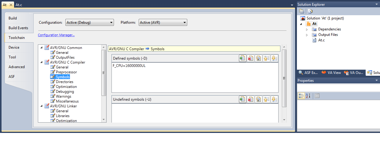

in avr studio6 i went to Project menu → Filename Properties (Alt+F7) → Toolchain → AVR/GNU C Compiler → Symbols → Add F_CPU=16000000UL to Defined Symbols.
Photo:
https://obrazki.elektroda.pl/5037982900_1348952148.png
i searched through the net it seems like the only place where the F_CPU should be defined in avr studio6.

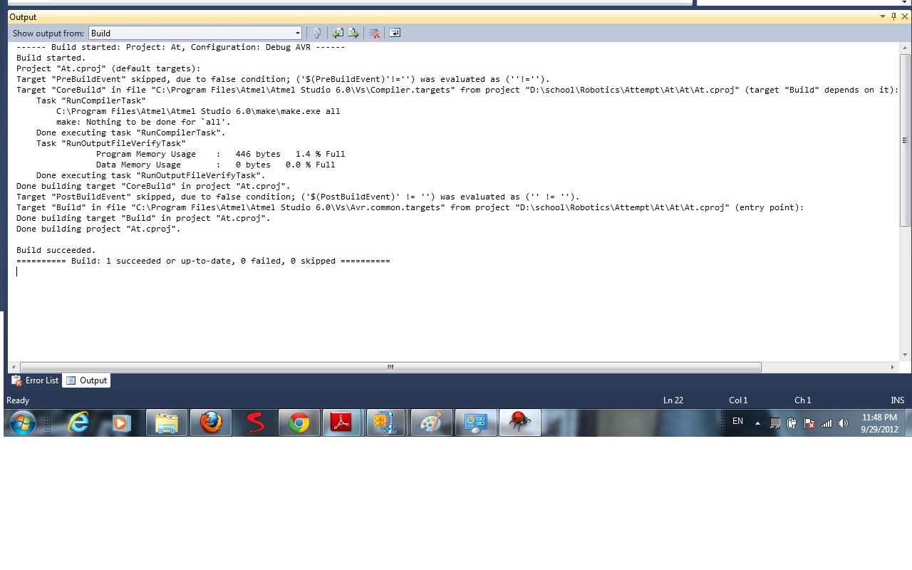

If the clock isn't detected in the delay lib then there should be a warning
# warning "F_CPU not defined for <util/delay.h>"
Do you see such a warning in the compile log?
