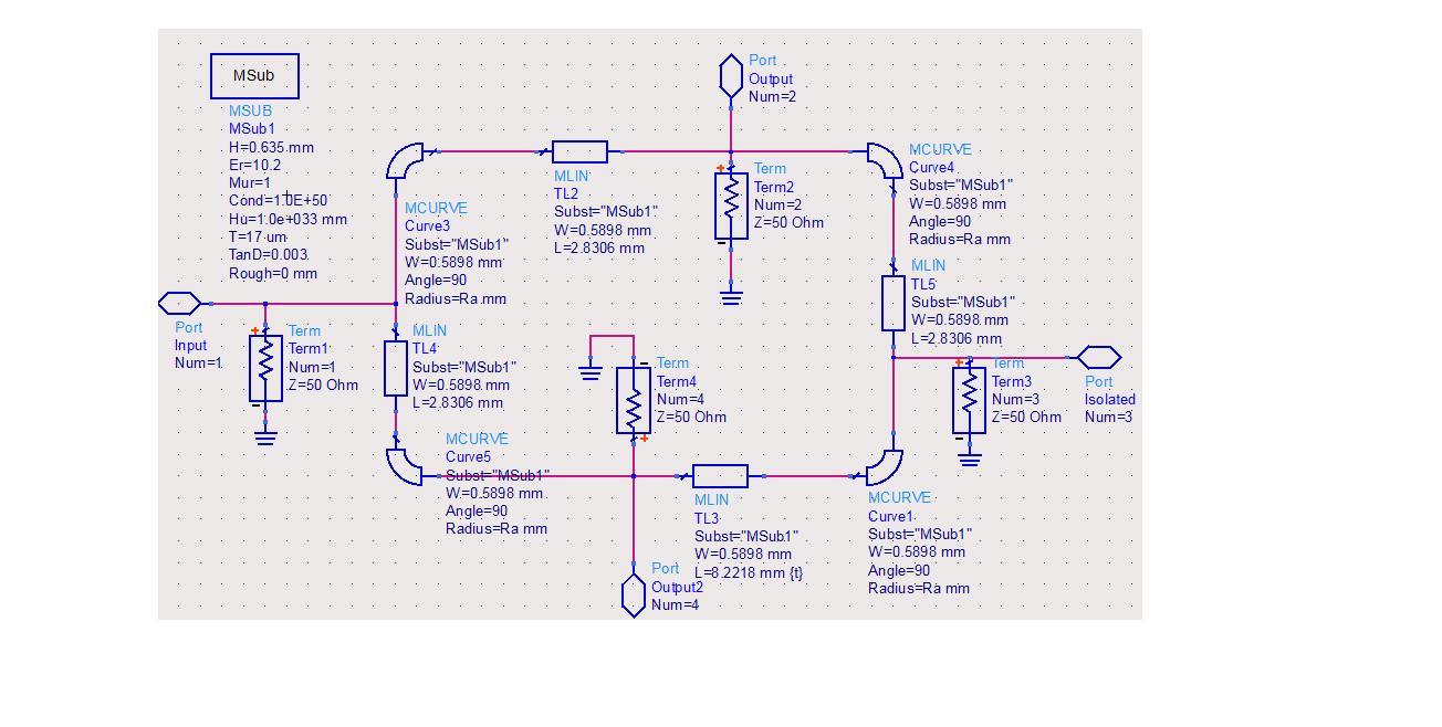

Hi all,
i am working at Rat-race coupler and i have a problem in calculation raduis of the ring in ADS design, i saw that it should be squre(2)Zo but i think it's not correct!!!
i attached the figure of design
