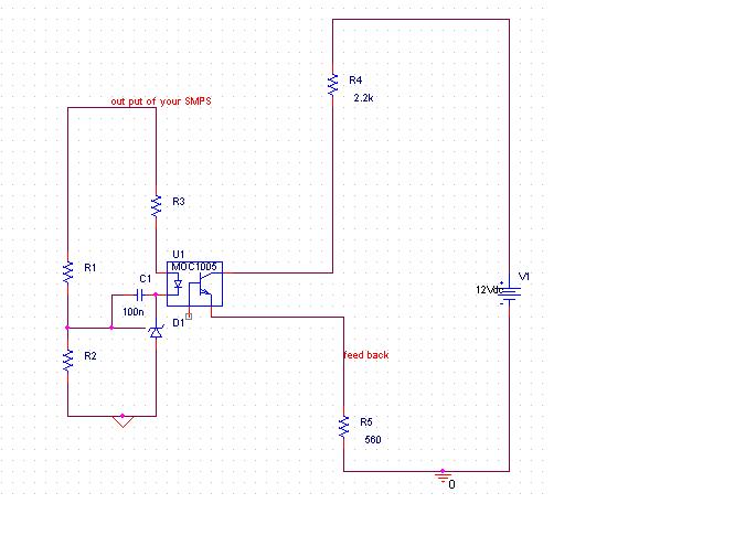

Typically, an optocoupled feedback loop would use TL431 or some other kind of secondary voltage sense circuit.

As FvM said , you should use a variable zener such as TL431 ( it will conduct at voltages above 2.5 volts) and it will be in series with an opto coupler , and at primary of your opto coupler you can get a feed back voltage from emitter ( with two resistor , first one in collector and the other in emitter ) .
Best Wishes
Goldsmith

I found a feedback with opto and tl431 .the TL494 with the feedback is in the picture . is this proper for my circuit? when you confirm my circuit I will begin to draw the PCB and work on it .

The feedback polarity isn't right in the present circuit. I noticed, that the TL494 datasheet doesn't give much application details. Some more are here.

Hi again , try below circuit :
the voltage across your feed back resistor should be about the internal reference ( 2.5 volt i think ) ( if moc be saturated )
Best Wishes
Goldsmith
