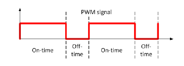

I was really confused when reading about the theory of H bridges on line. To rotate the motor at lower slower speeds the document says we use pwm signals. That point is understandable for me, but he says in pwm off states several combinations are possible. For example H1 can be ON. This is where it confused a lot for me, till this time i was assuming that pwm off means all switches are in off state. Please tell me the difference between system pwm off and each switch pwm off. Are they different or both same. Please help.
First of all, without a drawing it's a little difficult to explain. Regardless, you don't have PWM on each switch. Usually only the bottom switches receive the PWM signal.
Imagine: when PWM_OFF means that all switches are OFF...
Then what does PWM_ON mean?
* both switches ON --> this causes short circuit
* low side ON --> what is the high side good for when it never is ON?
* high side ON --> what is the low side good for when it never is ON?
Three possible modes --> none makes sense
The conclusion is that the first statement (all switches are OFF) is wrong.
Klaus
If you are using a half bridge, both switches can be off during the dead time (that just ensures that they have some time to turn off); this is important because turning on and off does take some time.
Both switches on is like suicide because the power supply line is shorted to ground; that should never happen in real life.
Hence there are two possibilities: H1 is on and that means L1 is off (else both on is not allowed) and the other one H1 is off and that means L1 is on (both off is allowed only for a short while).
Hence H1 and L1 can be driven by complementary signals. They are automatically produced by the driver IC
